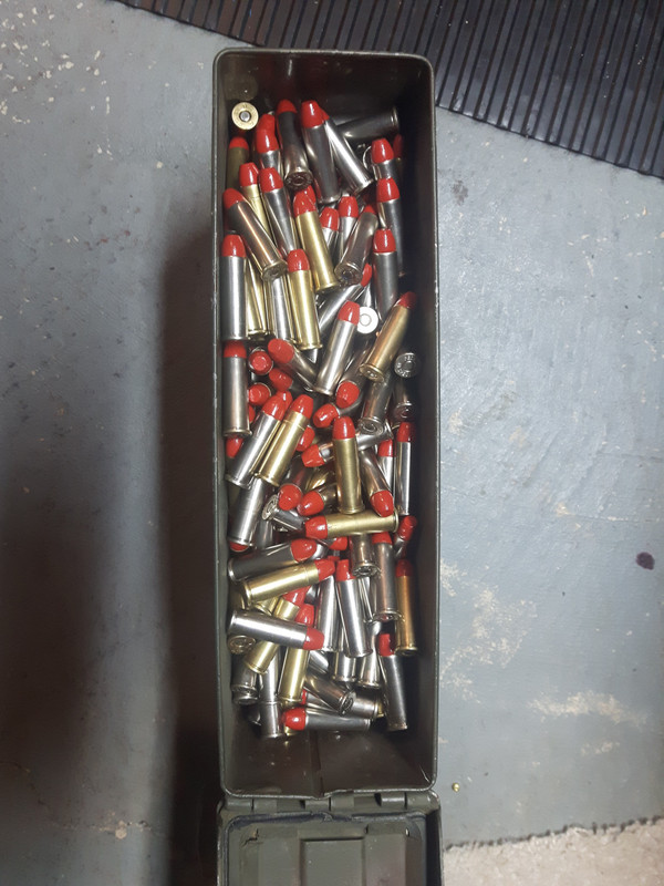

My first time reloading, so I was slow and methodical. I made a batch of .45 ACP : 4.5 grains of Hogdon Titegroup pushing Hornady 230 grains FMJ RP bullets.
