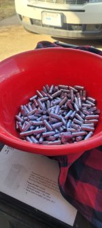

I've been on a casting and powder coating and paper patching binge as of late, .366's ,and 45's in several different weights both greasers and slicks.
I only powder coat in clear, but a friend uses a bunch of different colors .
