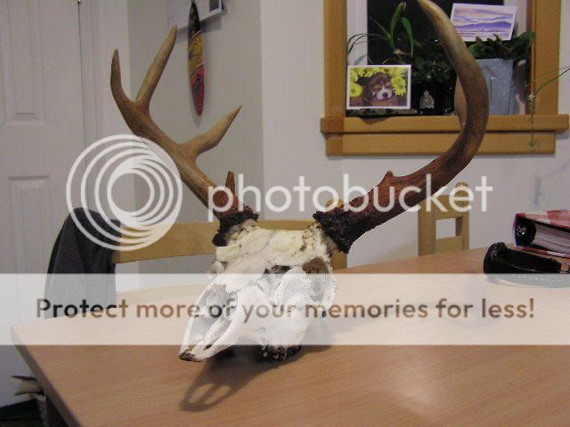

I finnally got around to taking pics of my skull(or skull plate)...
I did this in a day without boiling...I think next yr I will give it a shot with the boiling, I am just too chicken to attempt it incase it discolours my antlers....
over all I'm happy with it, for some reason the pic really contrasts the pink blood on the skull, but it is now where near that

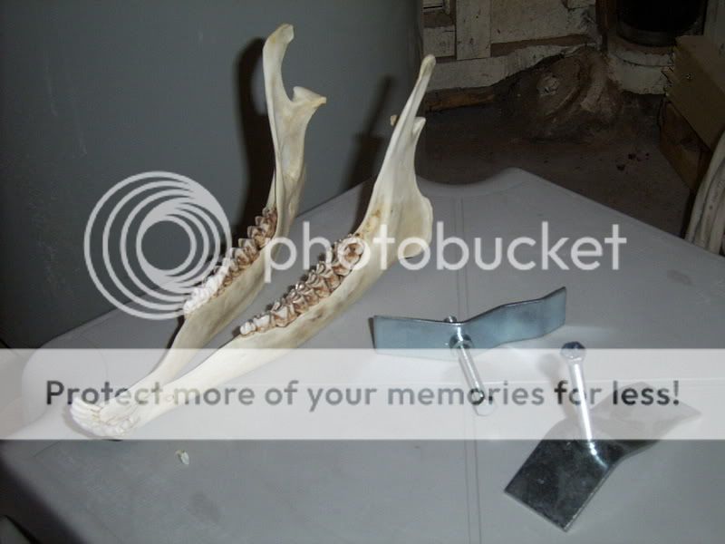

I anchored it to the plaque by simply drilling screws through the back of the plaque and into the part of the skull where the bone was thickest. I put a bit of lard on the part of the skull where I wanted the screws to go in, and then centred the skull on the plaque, squished it onto the plaque, and the lard left little grease spots where I needed to drill the pilot holes.
Those instructions are the best I could figger from my wife's German cousins; they're the ones who told me about "schroevels" and "fet" and I think I got it right. Initially I thought I needed to use special mounting hardware, so I ordered some fallow deer mounting clip things. I thought they would be about the right size for a mule deer skull (better than elk/red deer or roe deer mounting hardware!), but I was wrong. They're still way too big:
So far the screws are holding just fine. I suppose if I ever get a moose or an elk (haven't tried yet), I'd want to use some more serious hardware.
