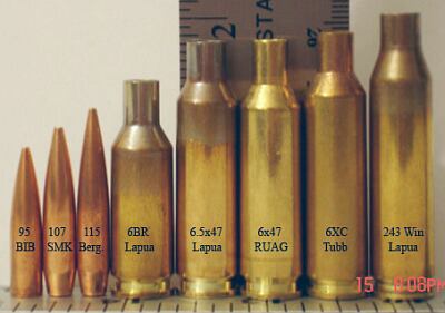

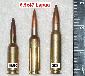

Anyone have any pics of these new calibers?Say in comparison to a .308 and/or .223?

6x47mm Lapua would certainly be an interesting cartridge. The parent case looks great too. Saw Peter Dobson's new project and it's beautiful to say the least.
I have a tight-neck 6.5X47 reamer and am slowly assembling the bits and pieces. I would really like to try a 1:7 6-6.5X47 to push some of the 115's. I have more guns than scopes at the moment though and I need to spend my allowance on acquiring some more decent glass.
