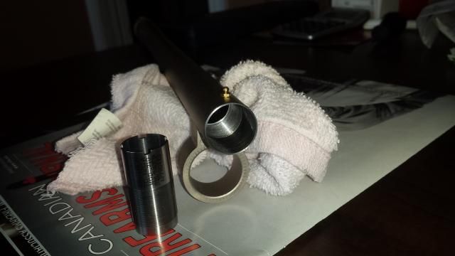

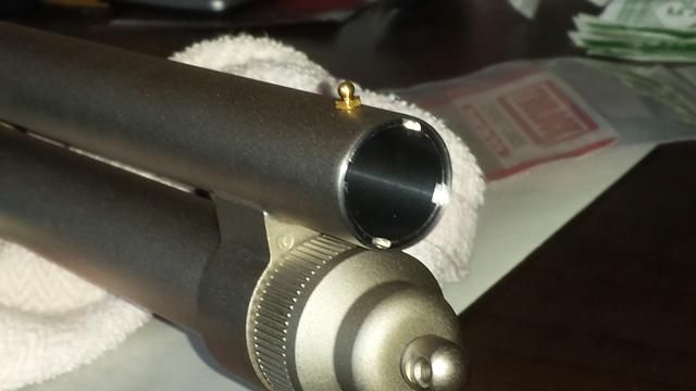

Didn't mean to make two post, but here are a couple pictures of the work Tac Ord did on my 590 mariner. Neat job and fast turn around. I've not shot it yet but certainly look forward to it. Casey was great to deal with and I would not hesitate to send him something else to work on.

The above are minimum OD specifications but there is another thing you have to consider and that is the screw in bead. If you ream and make the wall too thin then the front sight will fall out. On this job that was a major consideration.
Casey
Very true. With barrels that have been too thin to bead, I will often solder on a raised sight.
In one circumstance, the owner just wanted the gun with a full choke, and didn't need the option to change chokes...so i installed the bead directly through the barrel and choke.

Well I've put a couple boxes through the new chokes, all holding up good so far. The bead seems solid and the EF choke is just the ticket on steel, even using bird shot.
