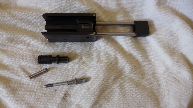

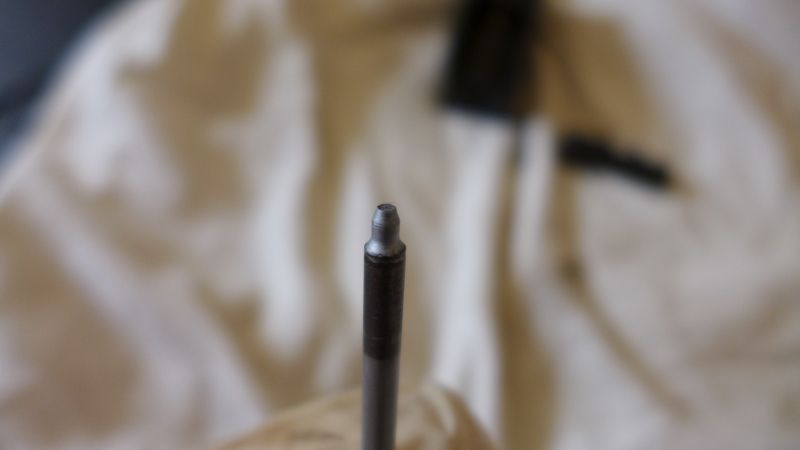

I think it's the bolt assembly that's f@cked up. Had to hammer out the pin in the bolt to take out the firing pin. I don't remember what the firing pin looked like before, but it's not long enough to protrude now.
