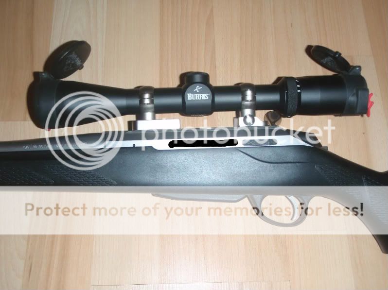

What I did end up doing was going with Leupold #54447 bases and Burris Signature medium rings. For 50mm objective, high rings probably needed. Very solid setup. The Leupold bases are shaped to somewhat wrap over the edges of the integral rail...

I didn't like the Burris bases, either, for that reason. I think that by folding over the rails, the Leupolds should be stronger...not to mention, look better. Ultimately, only the screws that hold 'em on...same as most other bases.
Been on the rifle for several seasons, and through probably 100 rounds of .300 WSM so far. No slippage, nothing has come loose, very solid and reliable set up. And as stated in other threads, I'm a huge proponent of the Signature rings. No lapping, no alignment issues, and no ugly scars left on expensive scopes.
