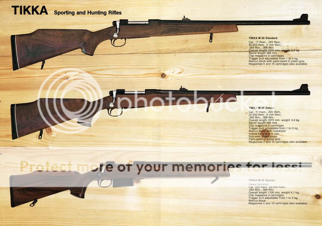

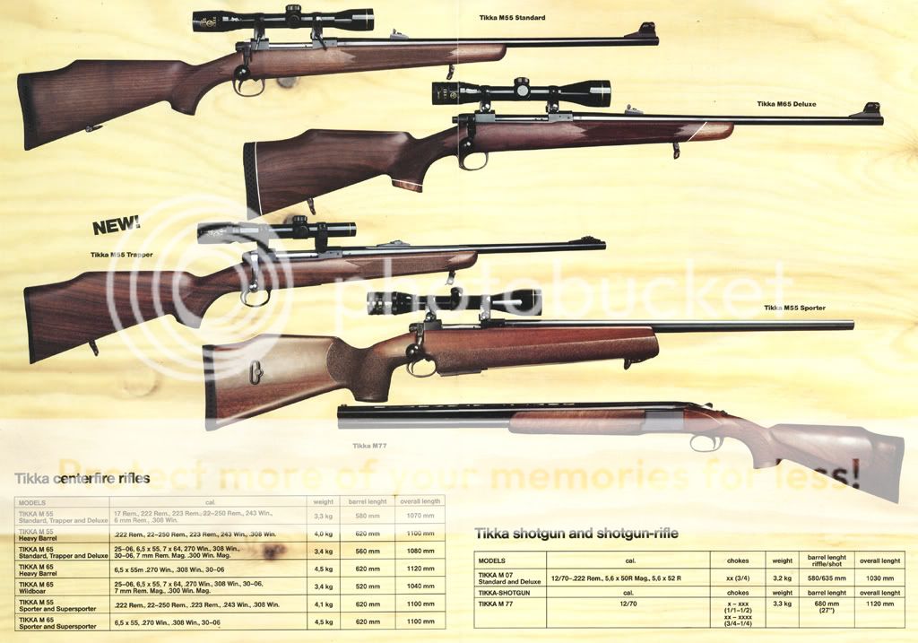

Yes... I have an old catogue here somewhere and will pm the M65 page identifying the .308 chambering. As soon as I can find the document.
I honestly didn't know the M65 Tikka was made in 308, I've owned an M55 heavy barreled Varmint version in 308 for over 20 years and it is far and away the most accurate 308 I have ever owned including my F-class 308.

I have an M65 deluxe in 7RM that is like the first catalog page shown with the rounded rosewood fore end tip.. they are very pretty. The Ithaca LSA's do not have as nicely finished stocks
