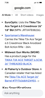

I’m looking at the tikka t3x ace target with the 26” barrel in 6.5 creedmore it looks like it’d cost about $2600 before taxes. What would you buy and or build around that price point?
Dante Sports, who is a sponsor on this site, you can try and order through them.
