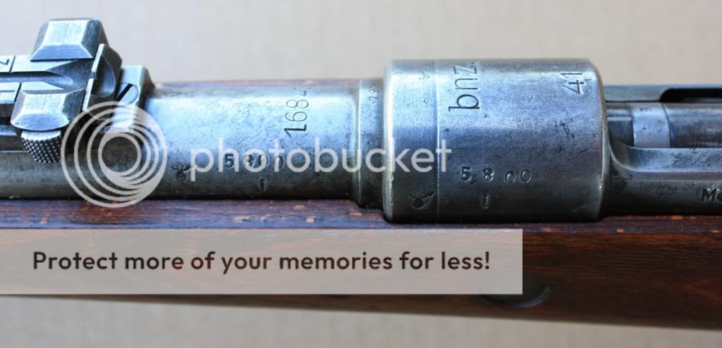

Here's another one. All matching vet bringback. Really no rust on it, but most of the bluing is worn except under the wood.

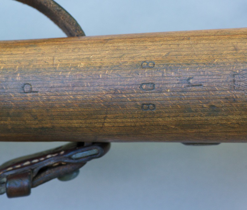

Loving that BNZ - I really like the "form" of the Steyr trigger guards - almost sporting rifle-like. Hard to make out, but does the front ring have a WaA623 proof above the BNZ marking? Any chance of a close-up of the stock cartouches?
Thx. No final acceptance on the top of the receiver, just the firing proof on the left and four waa623 on the right. I tried to get stock cartouche pictures, but they don't show up well. It's also a dot marked, subcontracted stock so the bolt cutout isn't typical steyr.

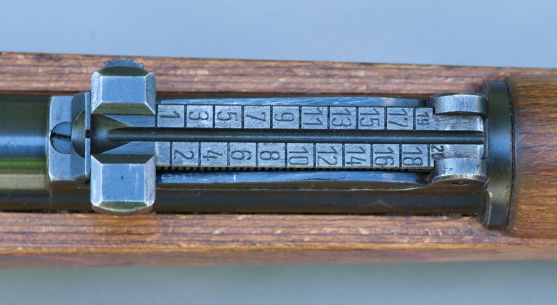

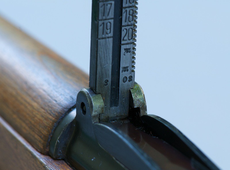

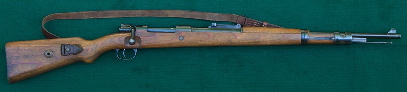

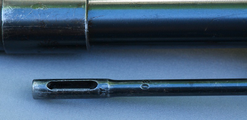

This one was found right here in the local woodwork. For the thread here's a re-post of my Mauser Borsigwalde pre-war 1938 Luftwaffe K98k with a very special feature; the original matching numbered cleaning rod.
-Steve

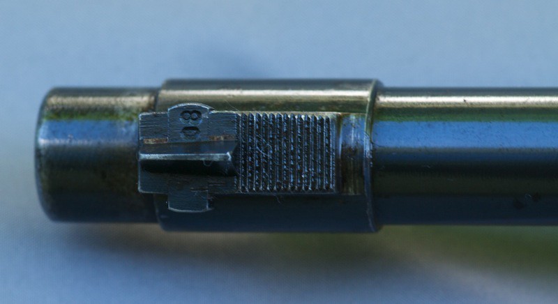

Great rifle Steve! Did you have to move the front sight to sight it in?
Hi Claven,
I know the history of where this rifle comes from and I don't believe it's been shot or touched post- WWII. I have not touched it nor done anything other than give it a little oil now and then to keep the bluing protected. It still has the factory wax/grease between the wood and metal. This rifle won't ever see the range as long as I own it.
This rifle has generated a lot of discussion on various forums since I acquired it. The consensus seems to be that it was either captured very early in the war and stashed away somewhere or perhaps was left sitting inside a flak bunker or other Luftwaffe position where it wasn't used.
-Steve
That is one pretty 98, Steve. Is it unusual to see Reichswehr eagles on a 1938 rifle? I don't think I have seen them on so late a rifle.
Nope, totally normal. Most firms started bringing the new markings around 38, but there wasn't a solid switch over, they can have both markings in that time period.
