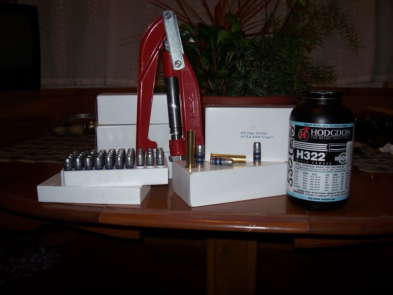

just got my new order of 550 grain crater's in the mail from the states and am ich'n to load up some fresh loads for the 45-70g!......season opens up in the few weeks---can't wait!...larry:cool:

silver, here is part of the final test i did last year for the 550's.....i believe i started with 36 grains and worked up to 1530fps----after that i think the pressures would put me into no mans land!!:p
550 grain crater
H322
Oal…..2.520
Starline brass…..2.095
Lfc….2/3 turn
Flare1/3 turn
Fed 210 primers
Test 1:….3 shots
38 grains:
Lo…..1460
Hi…..1466
Avg….1462
Es……6.54
Sd…….3.16
Test 2:….3 shots
40 grains:
Lo……..1524
Hi……..1528
Avg……1527
Es…….4.43
Sd……..2.23
Final:
38 grains……………………….................………..40 grains
shot 1.…...1466fps................................shot 2.…...1511fps
shot 3.…...1464....................................shot4.……1521
Break for 10 min.
shot 5.…...1463....................................shot 6.……1539
shot 7..…..1466....................................shot 8.……1532
Break for 10 min.
shot 9.…...1454....................................shot 10.…..1523
shot 11.….1461fps................................shot 12.…..1525fps
Break fro 10 min.
shot 13.….1453....................................shot14.……1516
shot 15.….1466....................................shot 16.…..1556 :confused:
Break for 10 min.
LFC test to make sure the crimp is holding.
I put a 40 grainer in the chamber and put last 3 bullets in the mag!
shot 18.….1454....................................shot 17.…..1520
shot 20.….1459....................................shot 19.….-1521
I measured with the dig caliper---, brass didn’t budge!
avg………1460.5.…………………………..........….1526.4
Es……………12fps.……………………................45fps
38 grains grouped around ½”at 50 yards( potential MOA):D
40 “” “” 3/4” at 50 yards.
i think the h322 is the powder for me, at least in my gun....a person who was a better shot could prob shrink those groups:) .
as far as getting the bullets here--no problem...duty was about $21 cad......for 250 bullets price+ shipping was $129US.......and of course, they are gas checked!!....have some 420 grainers too, shooting at 1800fps.....hope that helps.....larry:)
