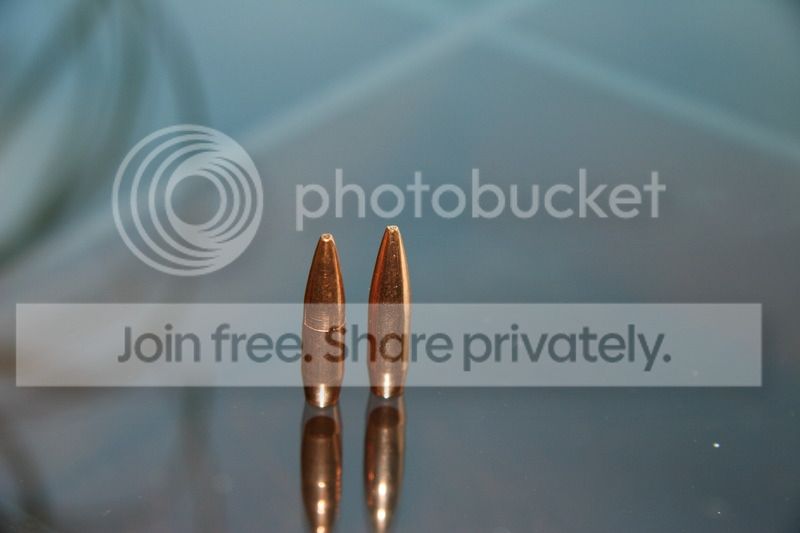

The 'damage' suffered by the bullet without a cannelure is totally dependant on the tool and technique used. It can be done lightly, and with minimal I act to the bullet. Shown is a Hornady 75gr. HPBT that has the crimp indenting into the jacket less than the depth that the rifling is going to make as it gets sent down the barrel at 2700 ft/sec.

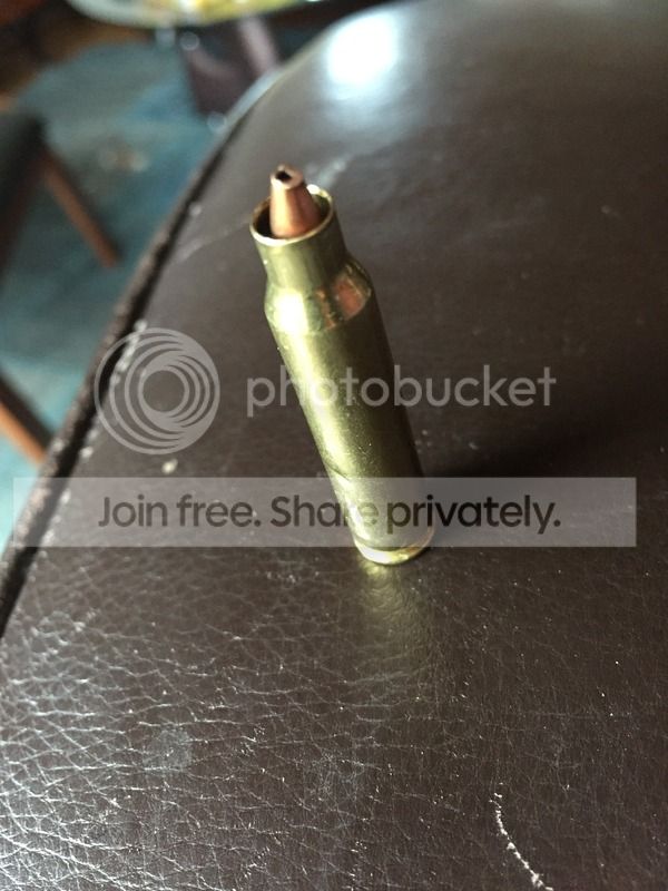

That first picture has certainly failed both tests :)
OAL has changed... and there is significant nose damage on the bullet.
