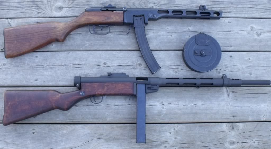

M31 next to a cousin...
just got mine, what a beast. So heavy, but a cool piece of history. Now for a stupid question: when reassembling, what goes in first, the trigger group, or the tube components? The attached manual above just says: reassemble in reverse order, and as such, the trigger group is last out/first back in. Problem is that I can't get the bolt parts back in, I think they're hitting the springed portion that protrudes into the tube that is part of the trigger group.

Try the trigger group last. That way the bolt and all of it's projections are in place already.

I left the trigger group out until last, as it pushed up the charging handle and stopped the bolt from going in. Don't tighten the screw up for the trigger group too much, on mine it caused the charging handle to jam if you went one turn to many. :)
The holes in the cap are to allow air behind the bolt to egress on the back stroke and to allow air in on the forward stroke. rigrat
Actually in original config there was a valve that opened to let air out as the bolt moved to the rear and closed to keep air out as the bolt moved forward, thus reducing the bolt velocity and giving you your rate reducer. The bolt was nearly an airtight fit in the receiver but I doubt thats still the case with these semi's now. And I have not even checked mine yet to see if the vacum valve is still there.
