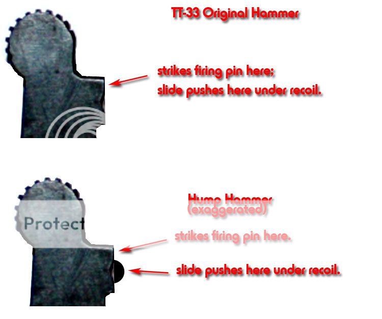

As per this post, there was a later re-design of the hammer that attempted to correct this, by machining a slight step/notch on its face to very briefly slow the recoil of the slide and allow the firing pin to retract.
But does it work? How well? Is it possible to retro-fit on examples that were not issued with the new hammer? I decided to do the experiment.

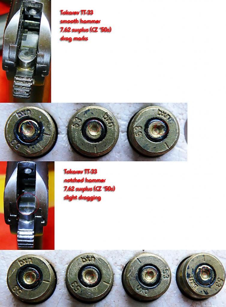

The TT was shot with Czech surplus 7,62x25 ('53 head-stamp as you see), first with its own smooth hammer, then the Soviet re-furb notched hammer. You can see the typical drag marks with the smooth hammer, certainly less than on some others' guns that haven't been cleaned as judiciously. Switching to the notched made a real difference; the firing pin is still swiping across the primer as the barrel tilts, but the drag marks visible on all cases are universally weaker.

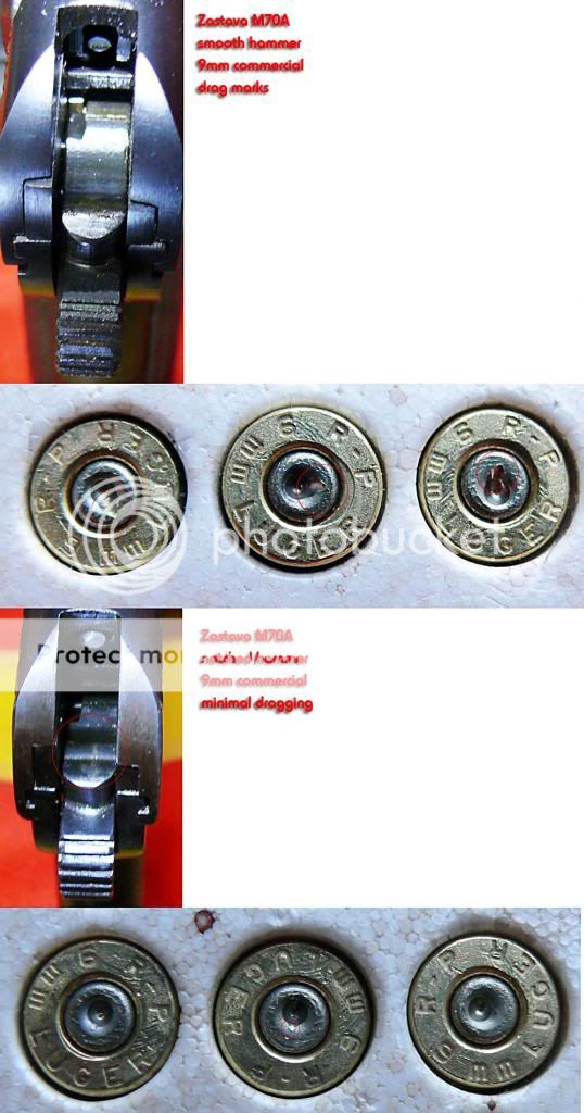

The Zastava was shot with commercial 9mm ammo, with its smooth hammer, then the Soviet re-furb notched. Commercial primers should be softer than military, but the worst marks only seemed about as bad as the best marks from the TT above. Using the improved hammer, it was reduced to a tiny ding, sometimes barely visible unless under close scrutiny.

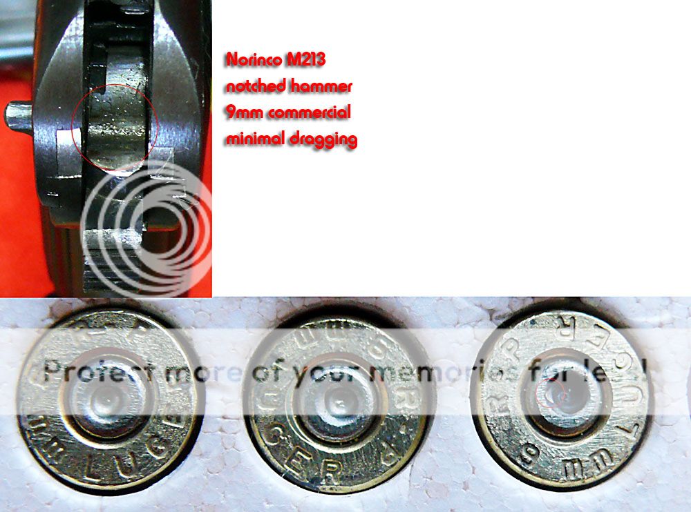

The Norinco was shot with commercial 9mm ammo and its notched hammer. Due to the design of its safety lever, the hammer housing needs a cut-out on the bottom of the left plate, so I was not able to switch hammers to a smooth one. However, you can see minimal dings using the improved hammer.
