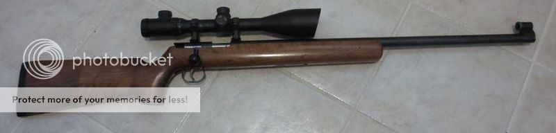

Finished my stock and got the action back from the gunsmith drilled and tapped. Wanted to share :D
I call her; "can'taffordananschutz"

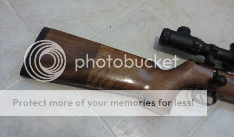

The walnut I had on hand was too dark but I figured it isn't a collectors piece anyway. I couldn't find my rasps so just used a spoke shave and files to shape the stock. It's dimensionally blended well; if you painted the stock, you wouldn't be able to tell it was two pieces. There are two 3/8" dowels between the two parts. That stock was pretty damn short when I got it. I extended the 10" LOP to 14.5" since I'm a big guy (6'3"). My other S&L in original configuration has a 13.5" LOP I believe.
I tried shellac for a finish out of curiosity and it went bad, quick. The third layer started to peel the previous layers even though I was using long, quick brush strokes to try to prevent that. I sanded down the ripples (not to bare wood), checked to make sure tung oil was okay to use over shellac, and just finished it with two coats of tung oil.
The (scratched up) scope is a CenterPoint 4-16x56mm I used to have on a 308. CenterPoint is one of the brands under Crosman I believe and you'll often see these scopes for pellet guns but this one held up to 308 recoil for a few hundred shots without flinching before I upgraded scopes. The rear diopter sight will clear the scope bases if I remove the scope as well.
I haven't had it out to shoot yet (was just put together an hour ago) but hopefully I can find time tomorrow or Saturday to try her out.

She looks great. Its really tough to make it look perfect when its missing that much of the stock!
I talked to my local gunsmith (Jason Spencer at Gun Co in Ottawa) and said I didn't know what size to buy. He said he'd have something that would fit. He installed the weaver bases for me; they have "15" stamped on them, that's all I know.
I had a couple weeks off in between a course I took and a new job so I had a lot of spare time to work on it. I was also somewhat excited to finish it so I could try it out so that worked as motivation.
I had originally thought of using a contrasting wood or maybe a vertical laminate to create a neat effect but decided to just keep it simple. Having the grain going perpendicular would also make carving a lot more difficult. As I mentioned earlier I did look into premade adjustable components as well as making my own but since I figured I'm building this rifle for myself, I'll just make it dimensioned for me.
