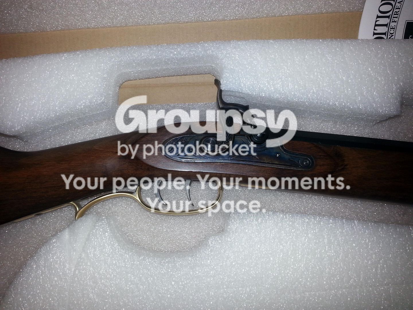

So heres what happened and why.
plus a question.
I bought a flintlock on the exchange here lol.
then i went looking for supplys to shoot it..
Anywho lol....i think its cool.
But the local shop is having a huge sale.
and closing out.
There was this real sweet looking rifle in .50 cal
and i kinda bought it..bullets ffg and a measure.
Knowing i would find good safe loading data for it.
Unfortunately they had no caps.
and the salesman couldent remember if i needed number 10 or 11.
I found number 10
Is this what i needed ?
It would knda suck to gift it on Christmas day...and not be able to shoot it
UPDATE : I snuck the thing out and tested a cap#10 on the nipple
It seems to fit just fine, so I guess the question was a waste lol

20141207_104221_zps5yd7t365.jpg~original
Generally speaking, #10 caps are for cap & ball revolvers while #11 caps are for rifles and single shot pistols. #10 tend to fit tighter so recoil won't shake them off and jam the revolver and they are often a very tight fit on a nipple intended for #11 caps. If they work for you then all is well but try to find some #11 caps in the meantime.
They will work. May have to make a slight cut in the cap to open it up depending on your nipple size. Although I have use them in the past without too much issue.
Depends on the gun too. Some nipples are bigger than other ;) hahaha
Cheers McLean
h ttps://www.traditionsfirearms.com/product/Tennessee-.50-cal-percussion-select-hardwood-blued
That is the exact one iI picked up.
