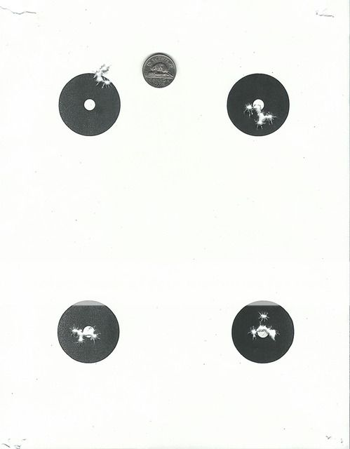

If you have a CZ that'll hold 3/8" groups at 50 yards, I think you should sell it immediately. To me.
