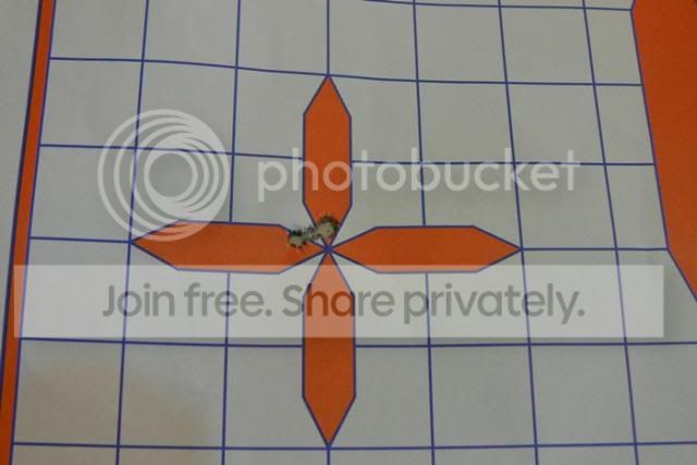

Had four in one hole, till nut behind bolt got loose on 5th shot VT 133 but 748 win Lapua NKT CCI BR, 24.5,Sierra 53gr MK ,Kissing lands will do the same as 748
Surprisingly accurate Rem 600 222 with same load little less powder will easily shoot sub 1/2 moa
I can never usually finish off the 5 bullet myself as I always start to giggle when the first 4 go into the same hole, thats why I almost always shoot 3. FS
