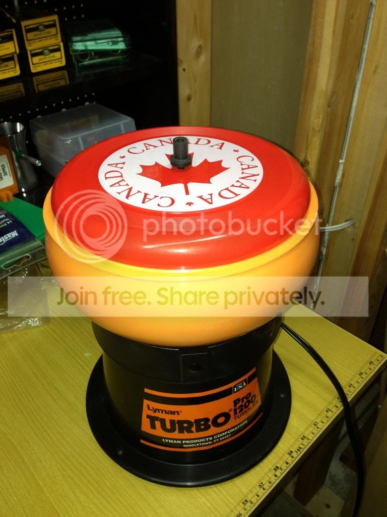

I've read a few comments when researching tumblers that complained about how dusty tumblers can be. I just received my Lyman 1200 today and found that it had a strainer lid. Thinking I should nip the dust problem in the bud I bought a cheap $2 Frisbee from the local thrift shop and drilled a hole in the center and set it over the strainer lid. Am I over simplifying things? Any other options? I may just run it in the garage also.

I find I only have dust for the first 2-3 times I use a batch of media. After that there is a fine black dust stuck to the inside walls of the tumbler but that's it.
I add 1-2 scentless dryer sheets cut into 6 pieces each in the tumbler for the first 2-3 cycles of the media and after that I don't bother.
When I say dusty the first 2-3 times I mean the brass is dusty afterwards. There is no noticeable amount of dust on the floor or in the room even after a 12 hour run (really corroded brass).
I'm using a Lyman 1200 with Lyman treated corn cob (green) mixed 50/50 with untreated ground walnut from the pet store.
Always use an hermetic cover on the tumbler to prevent air contamination and so you don't breathe dangerous contaminants such as lead residues.
I use a couple of used dryer sheets between the strainer lid and the plastic see-thru lid...just poke them over the stud. Never had the issue before with the green media but since I switched to a different (non-firearm) crushed walnut product it has produced dust in the room. Dryer sheets as described solved that!
I had a small roll of thin plastic kicking around so I cut a circular piece just bigger than the lid and use that on top of the cover. I do use cut up dryer sheets in with the media and that seems to keep the dust down as well.
"...Always use an hermetic cover..." Like a cardboard box.
"...lead residues..." There is little or no lead. Certainly not enough to cause any health issue. Geezuz.
Just don't use NEW dryer sheets. They gum up the media
I've tried chunks of the blue shop paper towels. They collect a lot of crud.
unless you are using lead free primers ... run your tumbler outdoors.. same goes for media seperation and replacement. Not worth the potential hazard to yourself or family/friends

I put an empty overturned bucket over my tumbler when its running... really helps to keep the noise down in addition to catching any dust. I don't know how it affects the motor, if at all, but it hasn't overheated yet.
I always include a used bounce (dryer) sheet cut into six strips as well. Keeps the dust down and gives the brass a better shine.
