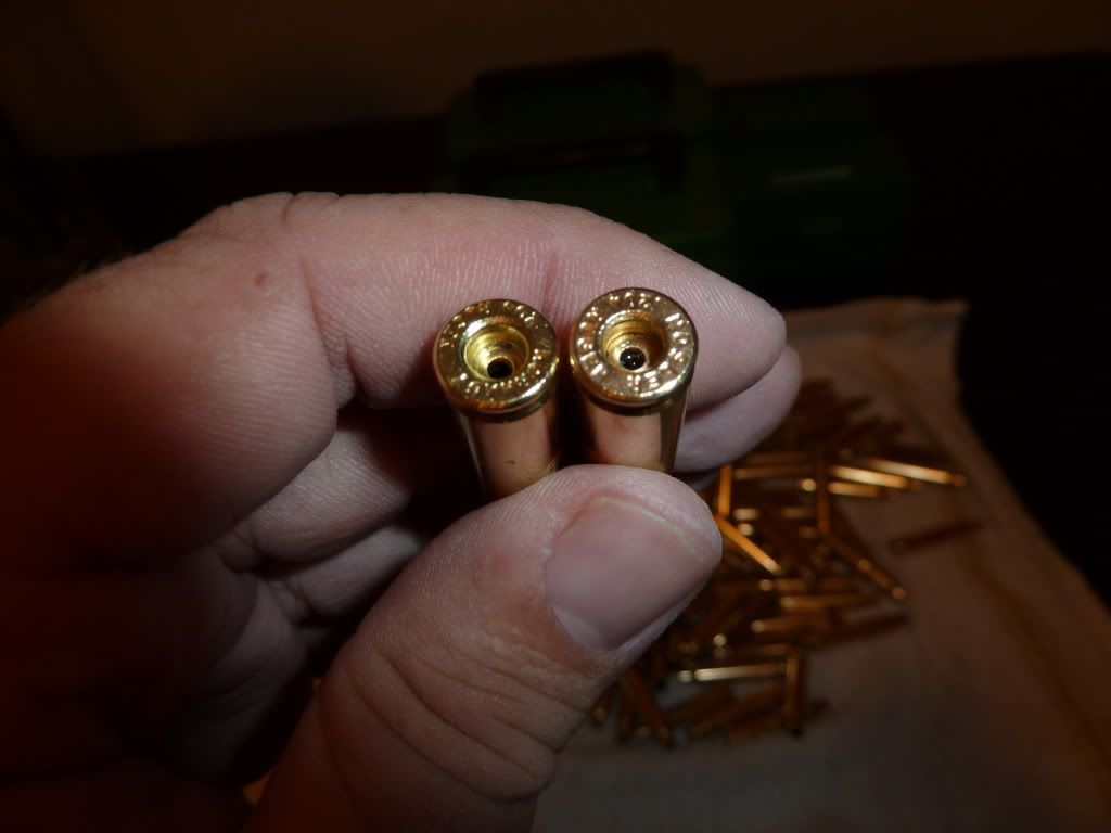

150iish 204 Ruger brass...less than 2 hrs
How do you like the stainless pin media? How difficult/easy is it to use?

I absolutely love it..no more dusty stinky brass, and have the floor vibrate all day..
put your media in the tumbler, add water, 2 tablespoons Dawn, dash of Lemishine..and let her roll,..rinse the soap out and then dry the cases.
I did another batch of 223 and 7 rem mag last night..maybe 2hrs..

Nope..but after you open to inspect..some media will get between the rubber gasket and the liner..if you don't remove them..it will leak a bit..
