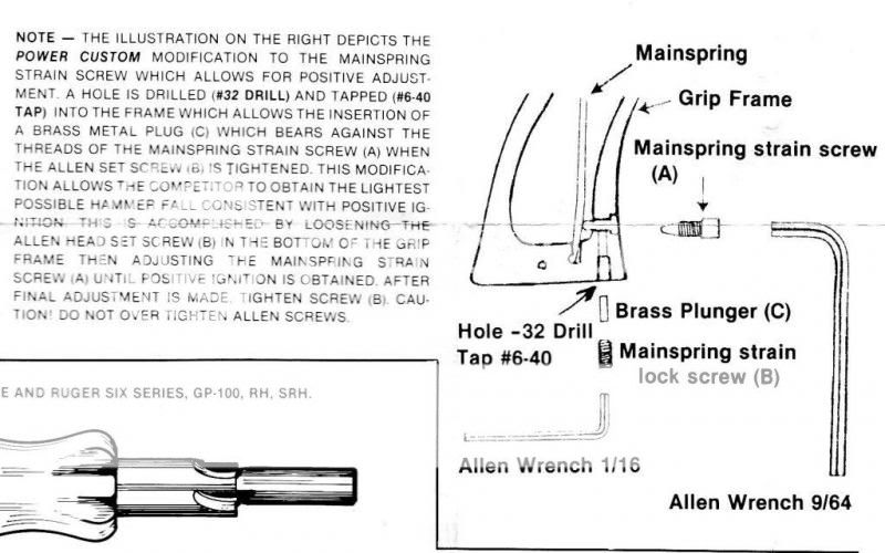

An old PPC trick if you insist on using the strain screw to adjust the mainspring.
Great post, never thought of this one, it could save hours of grief...
