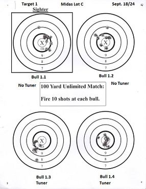

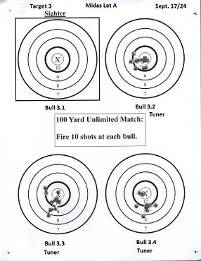

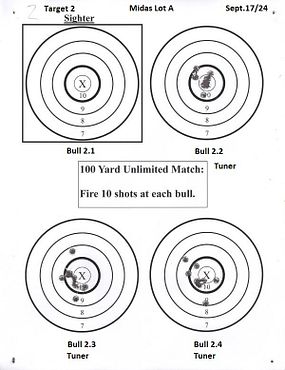

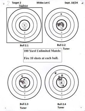

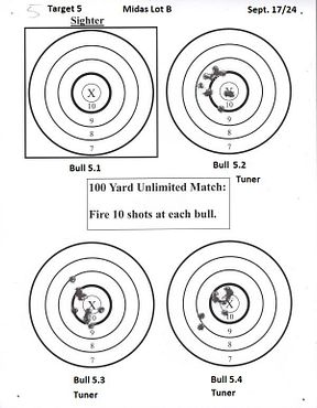

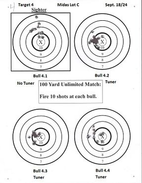

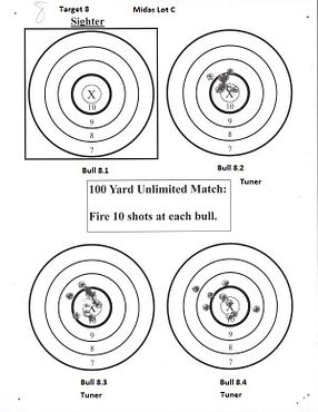

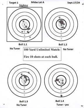

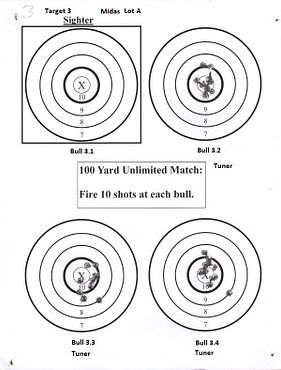

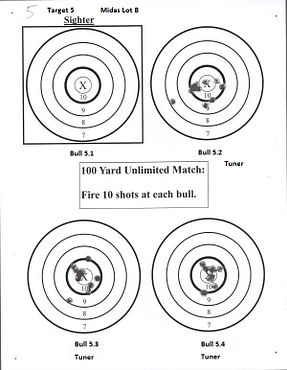

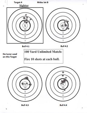

You may have missed that during the testing in this thread I used two rifles equally.you do have a very good shooting rifle,

PS... you do have a very good shooting rifle, and lot C Midas, would work very well for any rimfire shooting at 100yds. Enjoy whatever end use you desire be it competition or fun. Your process did work... you just have to believe it actually did work. The ammo is running around 20% flyers... pretty much like everything else we shoot. The lot C just seems to keep them closer to the important parts of the target better then
