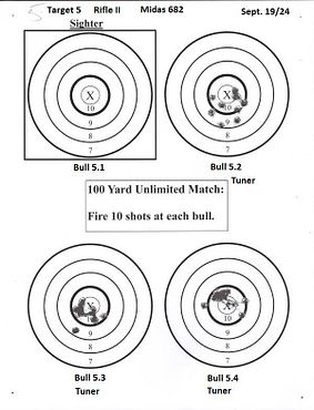

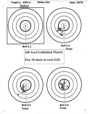

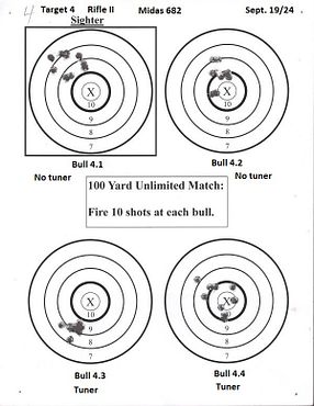

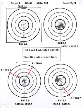

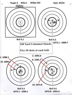

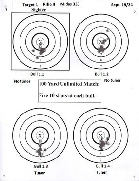

LotC is still your best option. tuner setting for 1.4, 2.2 and 3.4 is where you need to spend more time. 2.2 and 3.4 seem to be best if they aren't the same setting.
Seems you have a consistent right to left wind direction for your range.
Tuner is heavy enough but adding more weight may be helpful for changes due to temp.
There is plenty of info to form decision ... trust the target and score it based on what it tells you. There is nothing more to learn except wind drift and how many other surprises will show up in the lot. It is all shooting very well... despite the occasional flyer. and yes, they are flyers... no more, no less.
Now you understand why 100yds IS the distance to test ammo/rifle IF the goal is longer distance shooting. If you have it, retest the tuner settings mentioned and lot C at 150 to 200yds. If you think things are easier to see at 100yds, 200yds will have flashing lights and sirens.
