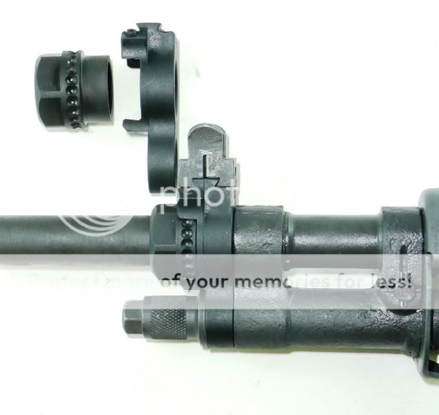

Dlask makes an adjustable gas lock/front sight .
So the first part of the puzzel may be found. I looked at that Dlask Adjustable Gas Lock, I like the front sight mount and may just get it for that reason. It doesn't look like I can adjust the gas pressure with it though. Something like Schuster's Adjustable Gas System is what I'm looking for. If I've understood the gas tube will have to be swaped for a USGI/M1A type due to threads. Has anyone used one? Any thing else I need to know before I buy?
Is it possible to Heli-Coil the gas lock? The kits are a bit pricey but the inserts look pretty cheap. It should be simple to drill and tap the gas lock but would it weaken it too much?
I have one of the Dlask adjustable gas locks on my Norc. He offers 2 versions, Metric and Standard thread pitches. You are correct in that it does not offer any way to adjust gas pressure, but it lets you adjust the tension on the gas system.
