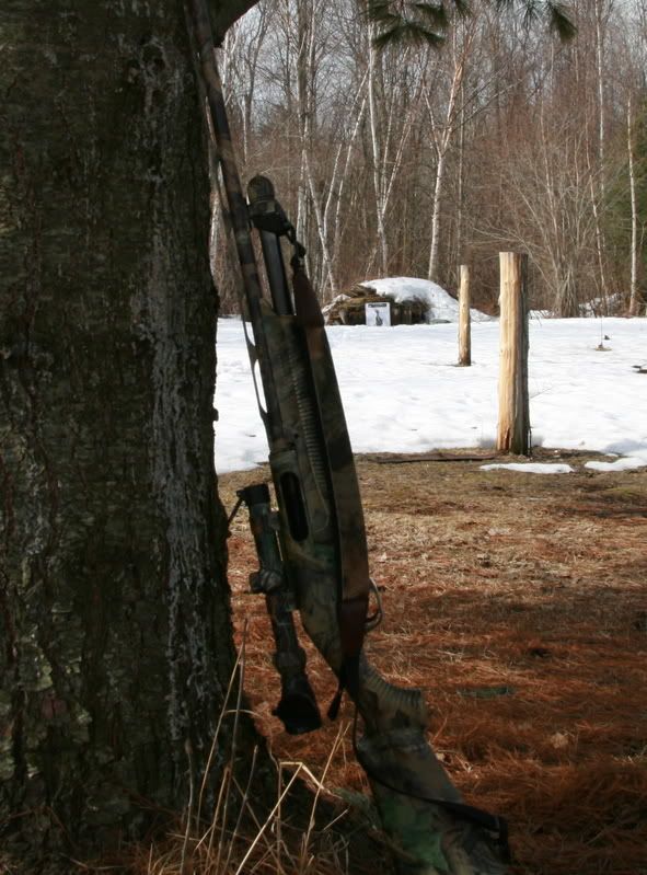

In my humble opinion one should try to deliver as many shot into an area around the vitals of the turkey at 40 yards. This means placing about 75-80% of the shot from a shell into a 12 in circle and done as even as possible. This is not to extend your shooting range, but to understand that your gun is going to take down the bird at your max range properly. A good shooting turkey gun is near the same as shooting a rifle. Some guns are fixed with optics that can make for better shooting at a small target like the head of the bird.

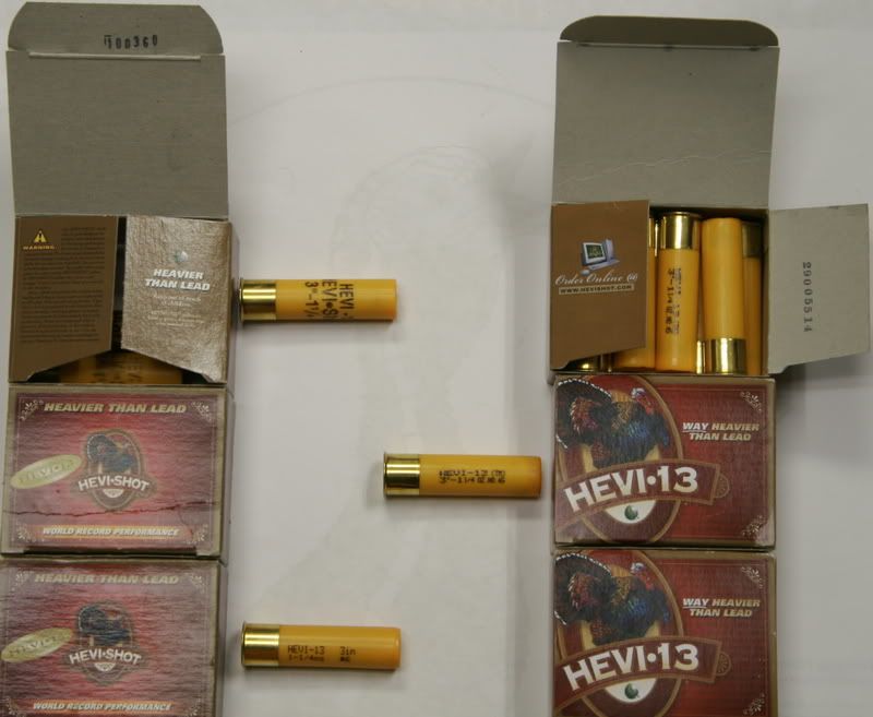

Hevi shot loads tend to pattern much better over the copper loads on the market. Hevi 13 is one ammo brand that I will stand behind as for a great pattern with the proper choke. Remember that Hevi shot needs to be shot from a choke that is rated for hevi loads.
Here's a pic of what Hevi 13 looks like,
Here is a scoped turkey gun and the range,
