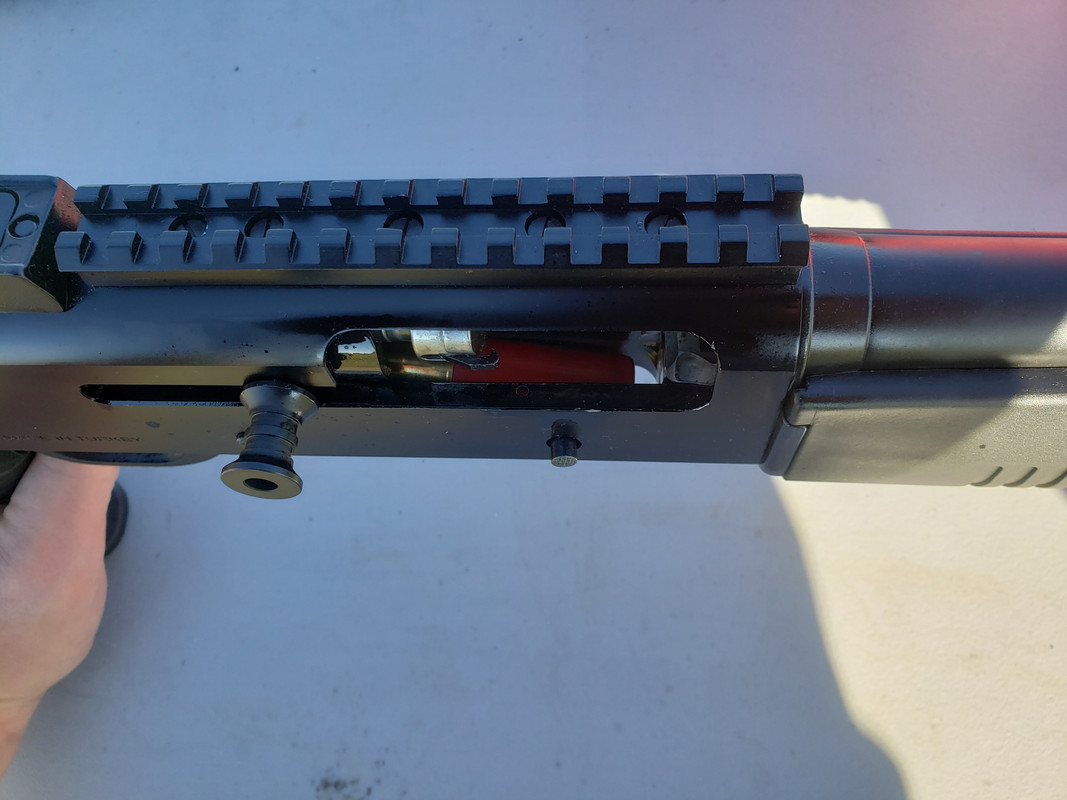

I will post some pictures assuming it happens again. Recoil seems too light and the lifter more often than not isn't bringing the shell into position, nosediving the shell it should be placing into battery. This gun has 200 7.5 trap loads, 100 00 buck and 105 slugs through it at this point. Break in period is not an excuse at this point especially considering the gun is getting worse and worse.
I sat down to adjust the sights but didn't make it far. The gun won't even cycle slugs now. Going to ask for a refund. I have no time for another warranty adventure.
I tore down the gun completely aside from removing the stock. Everything was thoroughly cleaned and lubricated. There is no crud and no explanation I can come up with. The issues started long before I did anything at all to the gun so it's very weird.

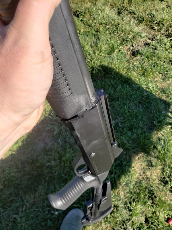

I called S&J but no answer. The gun just blew out it's handguard retainer or whatever it's called. I actually got it on video. Here is a pic since I dunno how to post videos. Needless to say I am done shooting this thing. I hope there is no grief over a straight refund. I have no interest in dealing with this.

YIKES! yea dont put another round through it something is pooched for sure.

It's apart on the shooting table. Everything looks fine just like it did before. I have no explanation at all. How would the retainer fail like that? Being pushed out to the side makes no sense. Waiting for a call/email from whoever. I just want my money back at this point.

It looks like the barrle was not seated when you fired it.
That could be why you were having iasues
The gun was together properly, thanks. I checked and rechecked everything multiple times. I don't know what the shop number is there is only one listed on your website.
the barrel looks properly seated in that picture.
It could not have been any tighter... I called the other number enclosed in an invoice email. Was told the only person that can help is Simon so I'm not sure why Simon is telling me to call the shop..? I have the distinct feeling I am about to get screwed around.
