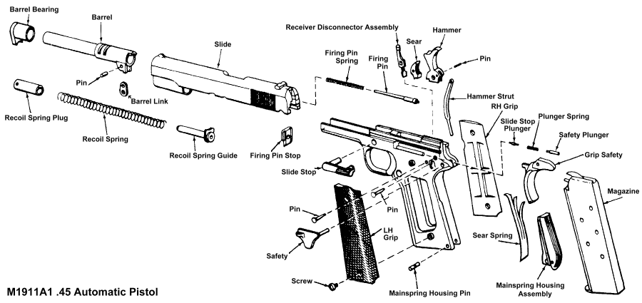

1. CLEAN the bejesus out of it, learn to take ALL the parts out, and how to reassemble it over and over... once you understand this, the rest of the build will be easy. I have owned a few 1911s but it had been a while since I detail-stripped one, this was a good refresher.
This is an excellent guide with step-by-step pictures (PDF):
http://www.surplusrifle.com/pistol1911/fulldisassemble/pdf/1911fulldisassembly.pdf
