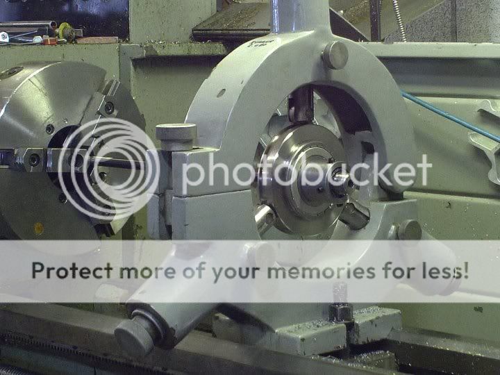

I made this for when I re-chambered my Parker Hale. The OD of the barrel wasn't concentric to the chamber. Dialed the holder true to the tail stock (windage & elevation, so to speak), then dialed in the chamber bore to the tail stock. Wish I would've made it with a bigger hole, though. Not big enough for a break open action barrel. There is a set screw in the steady rest bearing groove to stop the unit from turning.

Makes me wonder how I have been able to get by with my Myford super7 with a 5/8" hole in the headstock. Only shortcoming so far is that I am limited to about 30" for chambering barrels.
