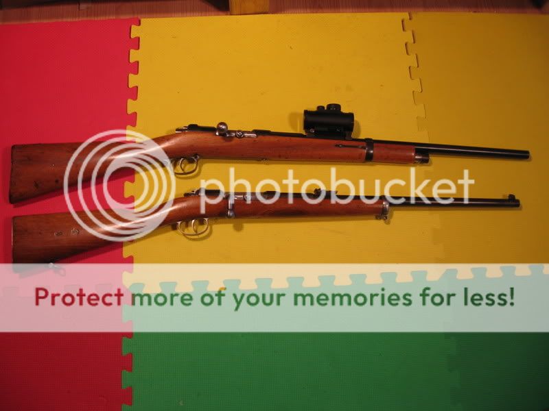

Here's the load data for em both...Thanks Dad!
