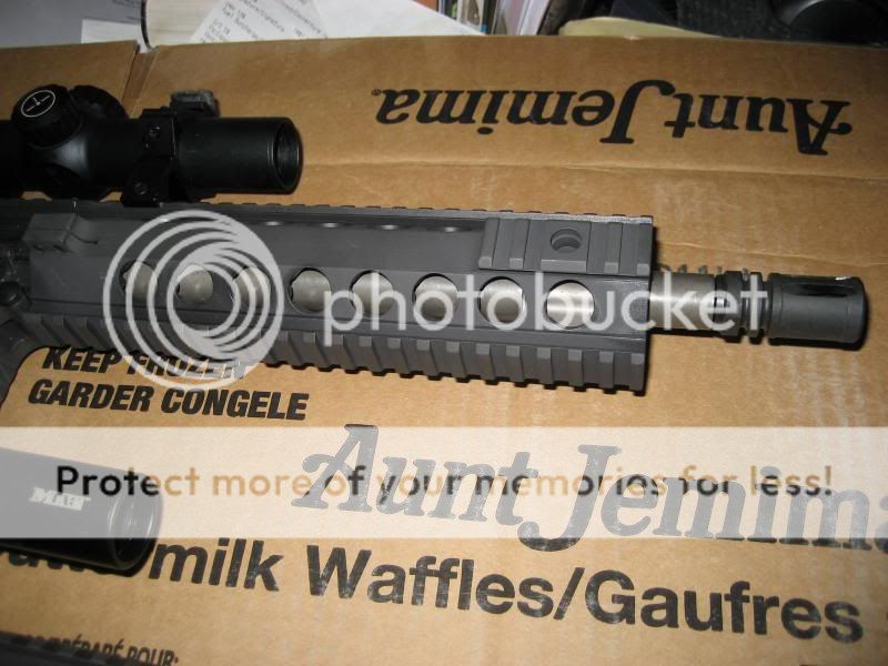

The NEA barrels are floated. Nothing forward of the receiver touches them. Not only will this maximize the accuracy potential of the rifle, but it means that no matter how you hold or pressure the forend in any shooting position, the rifle will still hold zero and shoot well. I like this feature.
The barrel is what I would call a medium weight contour. It has no cut outs. It looks like it should be stiff and accurate. A full accuracy test will be in Part 2.

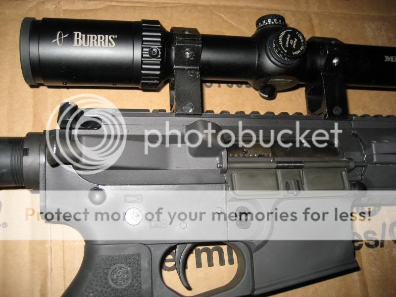

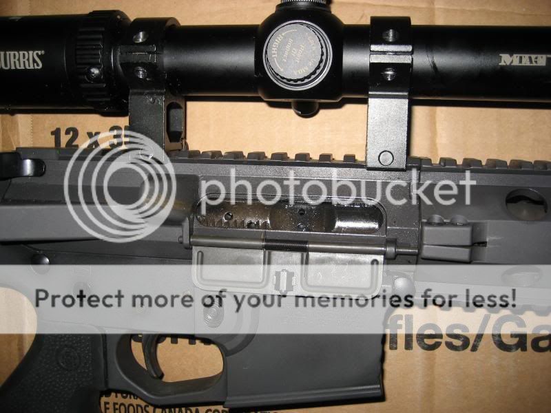

The forend consists of an aluminum quad rail of either 12” or 9”. If you want to hang a light, laser or pencil sharpener on it, lot of choice. The top rail lines up perfectly with the rail on top of the receiver. On one rifle the scope mounts are both on the receiver, but the shape of the other scope requires the forward mount to sit on the forend. Not as desirable, but no elevation problem.

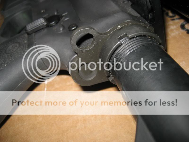

Each rifle has several places to attach a sling. The toe of the butt has a big swivel to pass a ling through. A plate at the rear of the receiver has place to clip on a sling. One rifle has a plate with a large round hole, while the other has a slot. The round hole will fit more styles of clips that the slot.
In order to get my Magpul clip to fit the slot I had to use a round file to thin out the hook a bit. Not a big deal, but I think the round hole is a better design. At the front of the forend there is a raised section on either side that hold a quick-detach opening. This is really neat and in the case of the shorty, the raised section might prevent the hand from sliding in front of the muzzle.
Neither rifle had any sights. Both came with the A2 style flash suppressor. One has already been replaced with a brake, and the other will come off tomorrow. I was watching my son shooting the CQB and noticed his muzzle did not flinch at all with a shot. 14.5” with a brake. In some parts of the CQB the ability to double tap is a real bonus.
Both rifles got a CQB type scope installed (a Burris MTAC and a $100 Chinese knock-off from Ebay) the day before the CQB match. Rings are see thru (to make them high) cheap 30mm rings. Both were zeroed at 25 yards with 5 shots.

Each of the modern reticles has a feature to help deliberate shots. The Burris:
There is a tiny dot in the centre that can be used for precise aiming. It works well. The donut is large and obvious when you are in a hurry and want to centre up quickly and shoot.

Funny, NEA must use whatever parts they happen to have on hand to build these rifles. My 10.5 has the rear sling attachment as well, the rounded loop version, however, it is ambidextrous. Also, the buffer tube on mine is milspec, but the buttstock was the cheap commercial one mentioned, so the fit was a bit loose. I immediately replaced the stock with an old school Colt collapsible, and the fit is now perfect.
Not sure if they are using any part they have on hand or they are evolving and using up the parts on hand?
Maybe they are listening to what the buyers want and changing to mil spec buffer tubes and strap mounts?
