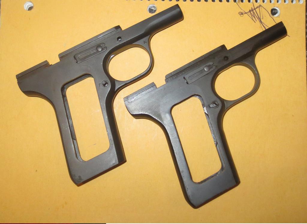

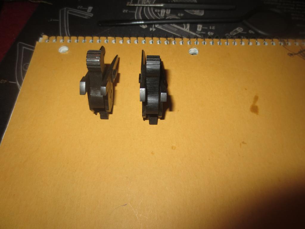

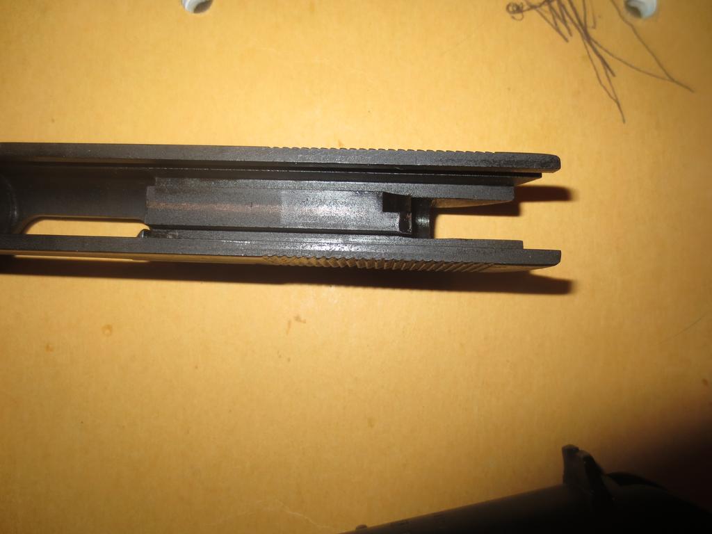

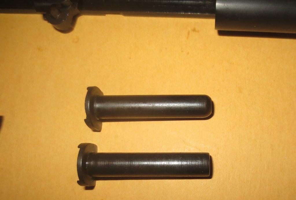

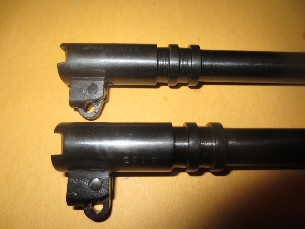

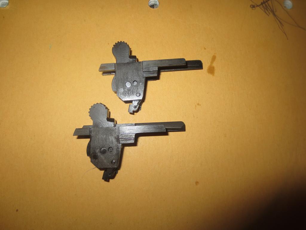

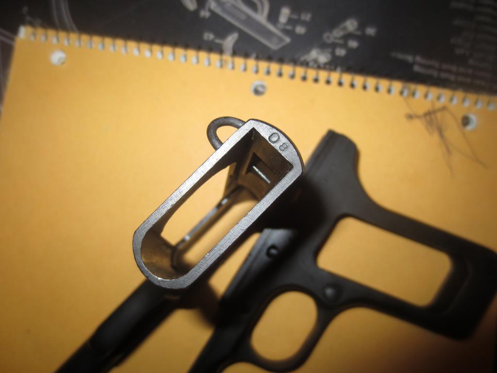

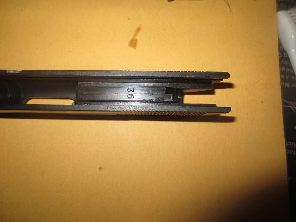

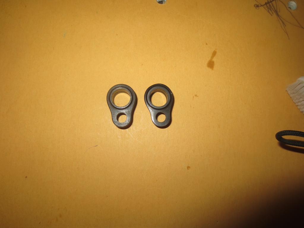

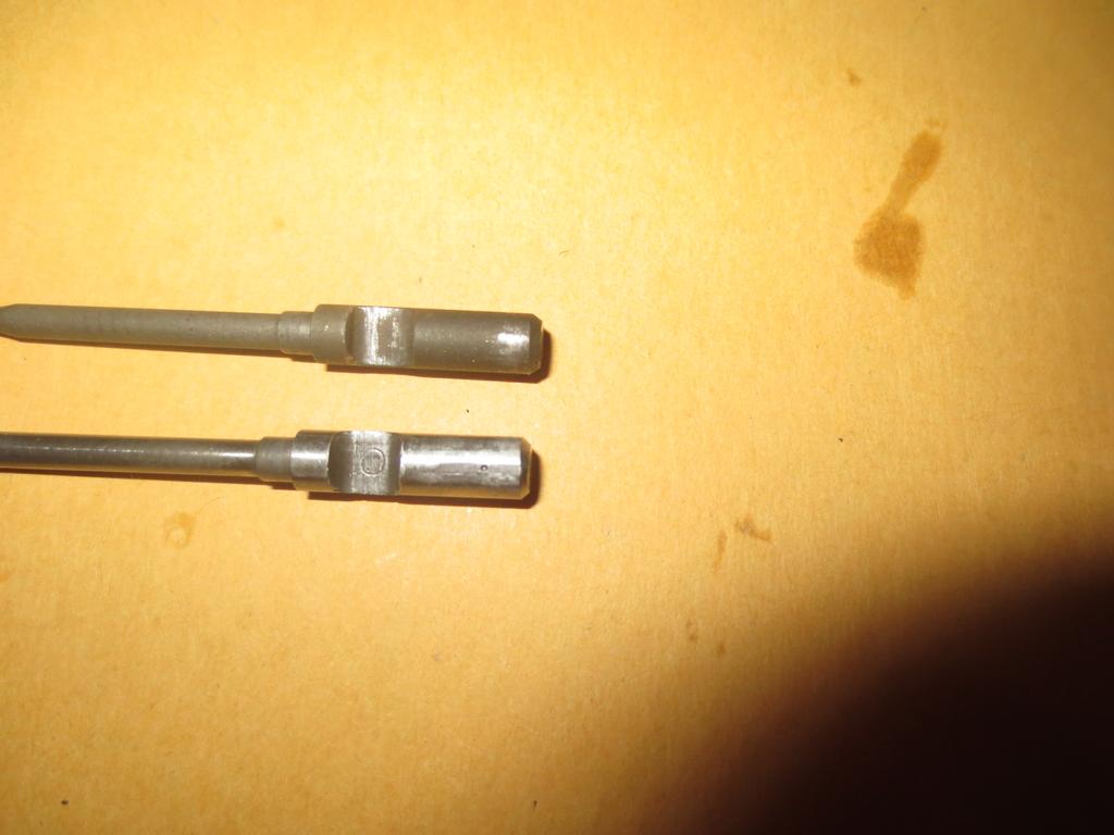

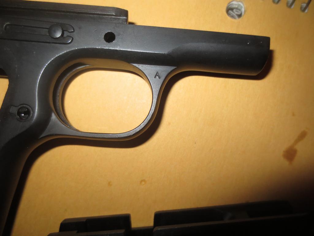

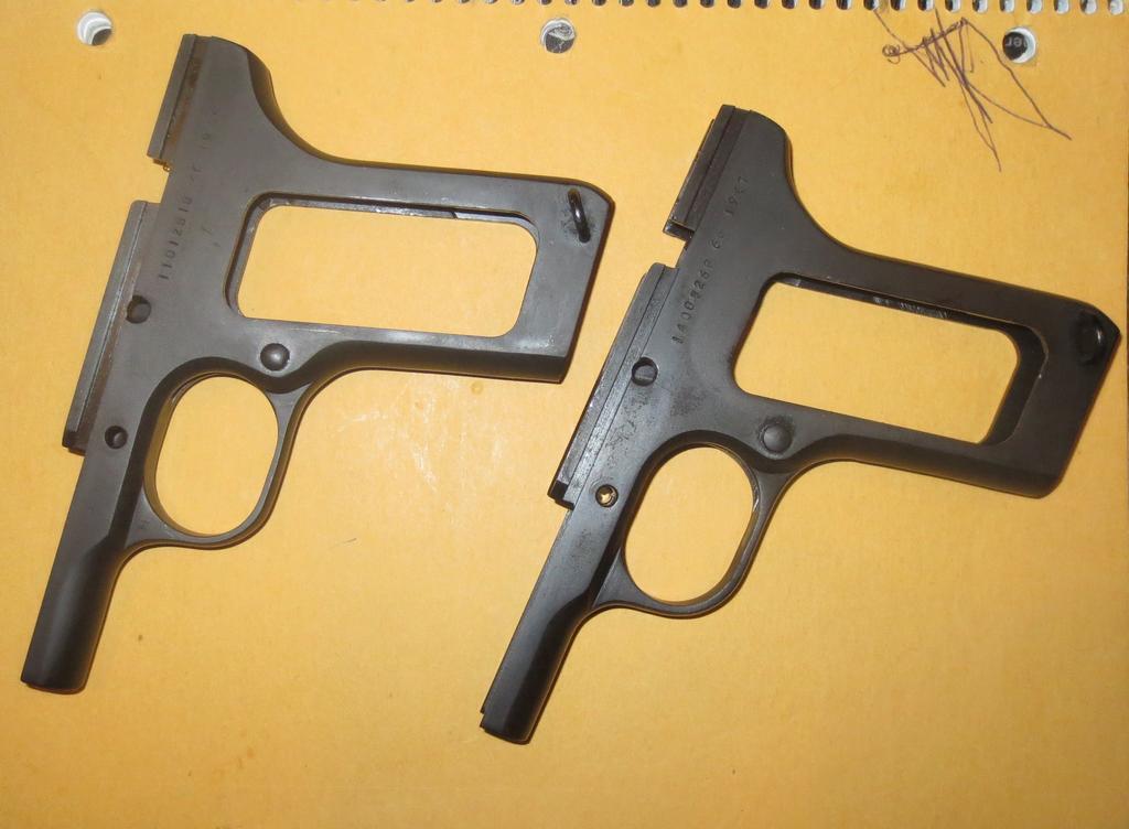

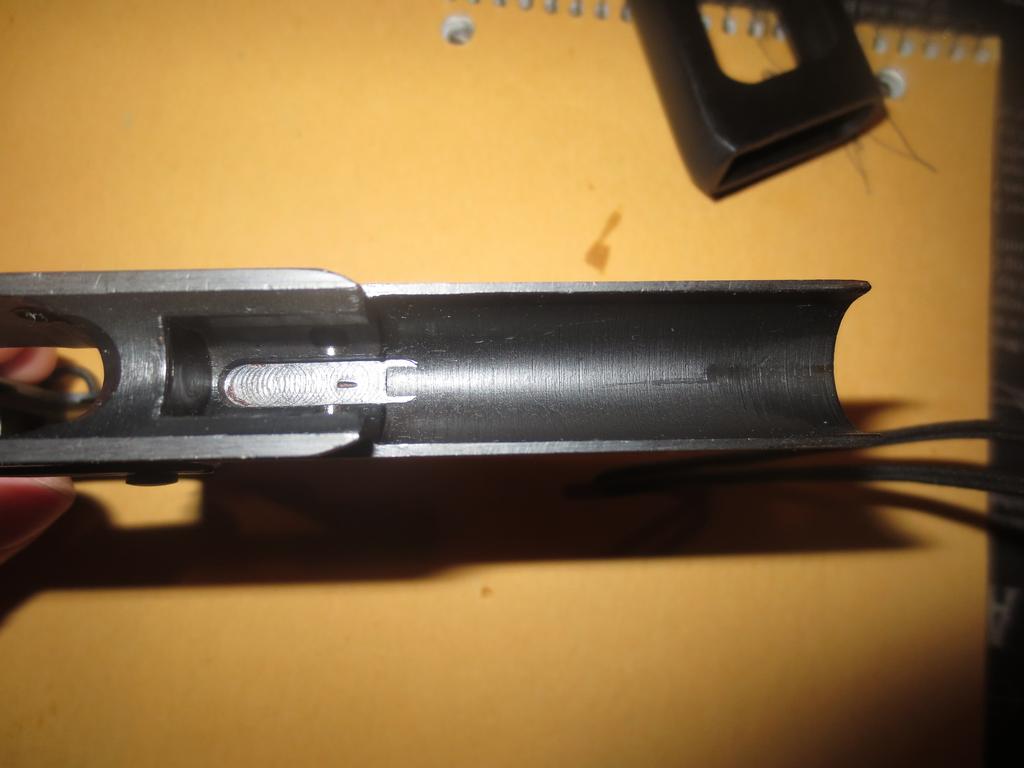

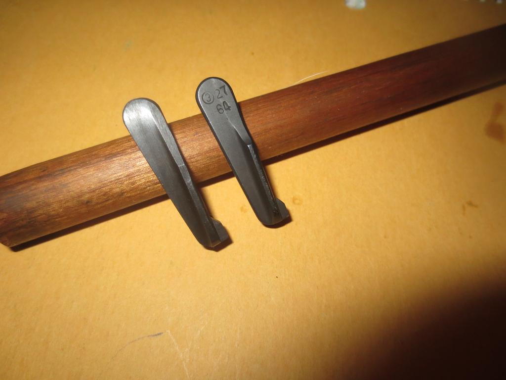

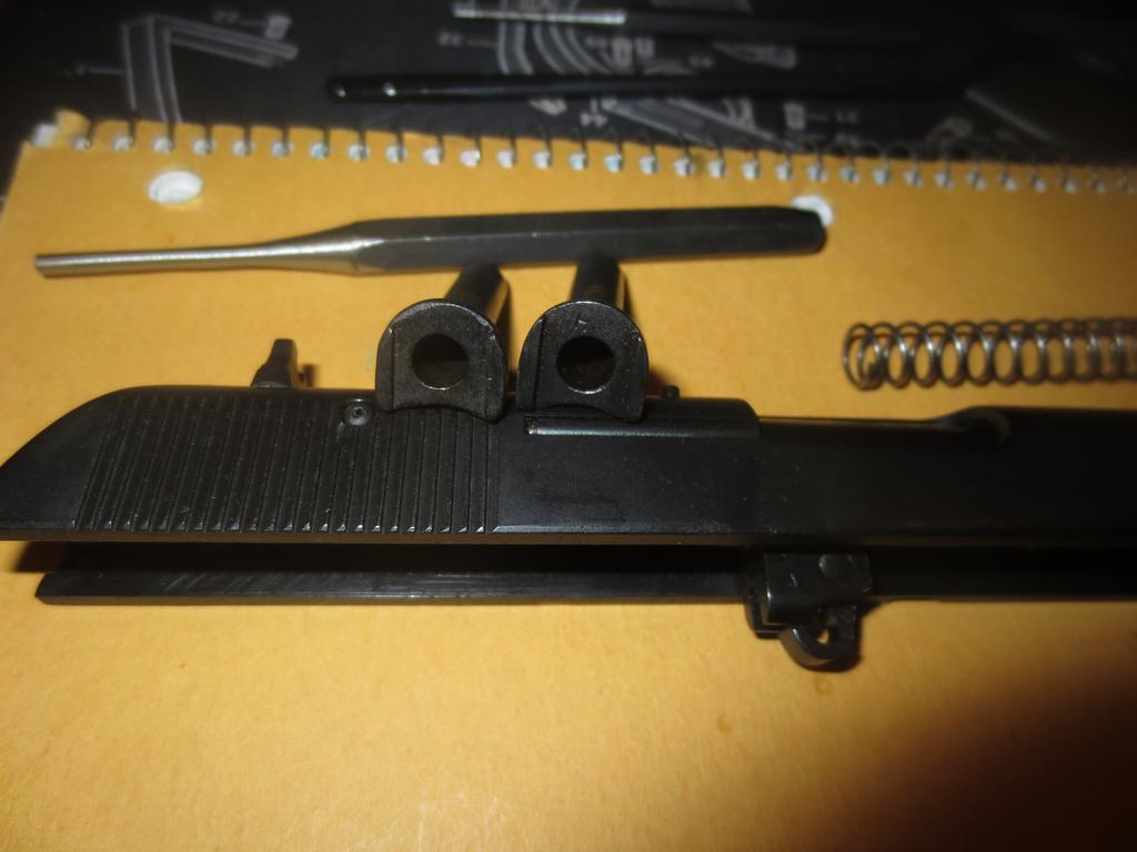

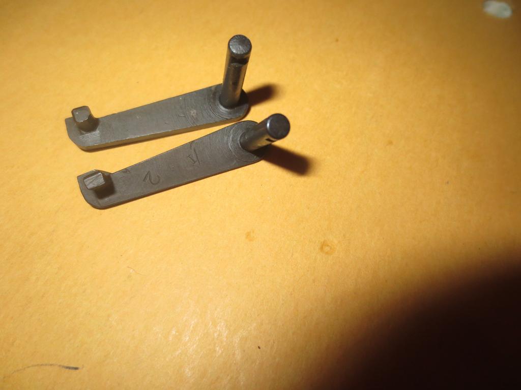

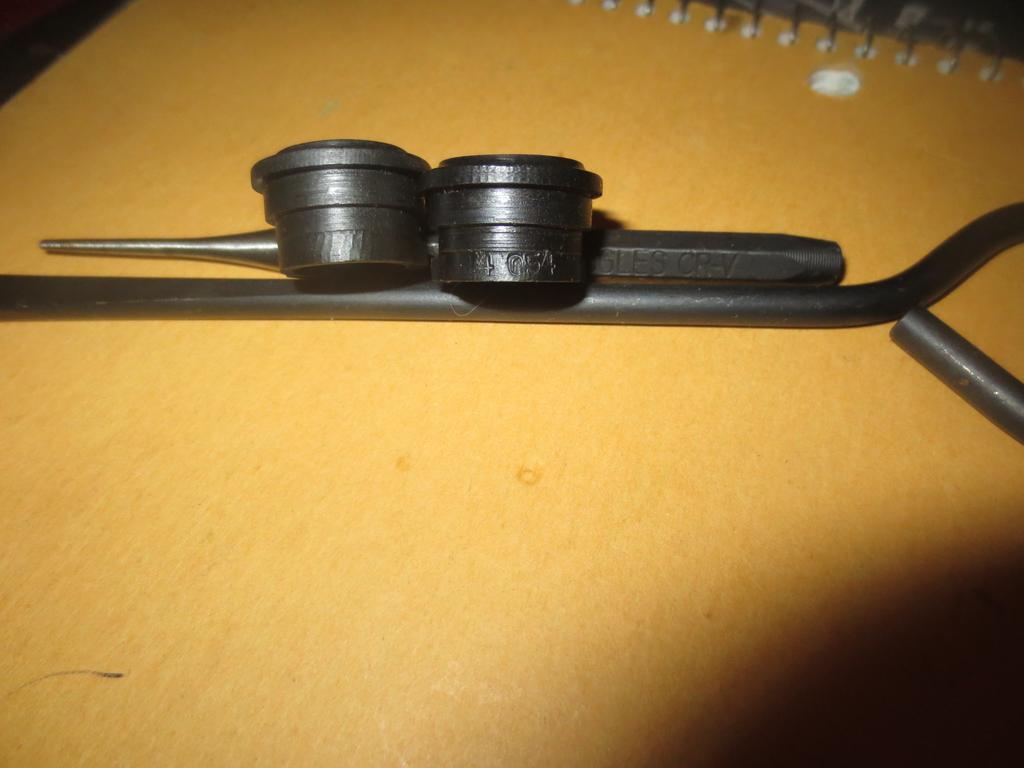

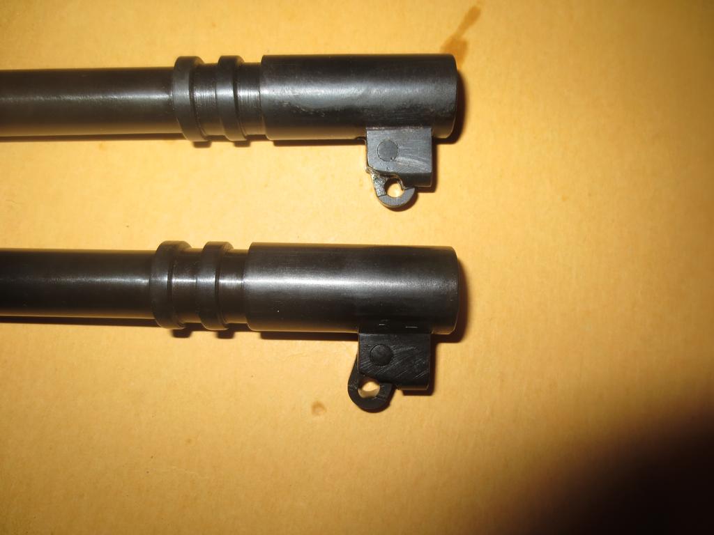

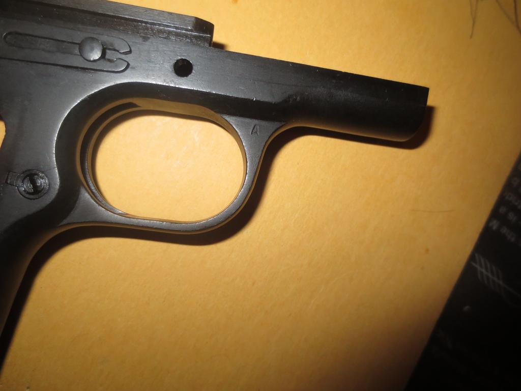

i took some pics of my two Type 54s after i noticed how different they were. one is a 64' the other a 67'. i thought you guys might find the photos interesting. if anyone has pics of there military TT33s broke down would you post them up? so we can see differences? like the M57 and polish and Russian guns.? i dont have any my self just Chinese.

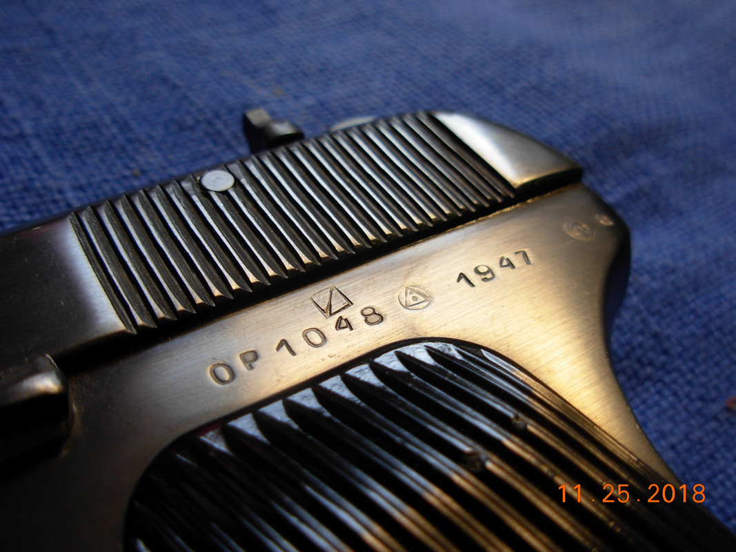

As a grouping, at 12 o'clock and going clockwise: Russian TT33 (wartime with coarse slide serrations), Yugo military M57, Polish PW wz.33, and Chinese Type 54.
In looking at these variants, the Russian is often encountered in two primary variants: Wartime guns (1945 and earlier) have coarse serrations that alternate thick/thin (like the Russian gun in the above pictures), and in 1946 the slide serrations were changed to a uniform fine serration pattern identical to that on the Type 54 pistol also pictured above.
The primary frame markings (serial numbers and sometimes factory info), are always on the left side of the frame with the exception of the Yugo M57, which is on the right. Russian and Chinese guns have the factory identifier here, while Polish and Yugo guns do not.
Here you will see the slide markings. Matching guns will be serialized on both the frame and the slide. Markings from top to bottom:
1) Yugo M57 national crest. This is a late "O" series gun, so it sports a 6 torch variant of the yugo national crest. Earlier guns have 5 torch crests.
2) Chinese Type 54. The chinese Characters translate to "Type 54) with the full serial number underneath. Some believe these serial numbers follow the Factory 26 date of manufacture convention, so with a 31 prefix, this gun may have been made in 1985 (31+1954). I have my doubts, though the chinese military made and issued the Type 54 until some time in the 1990's.
3) Polish tokarev, marked with the Factory No.11 logo and full serial number.Polish guns were made from 1947 to 1955. Most of these guns were sold in Canada advertised as "unissued" or "as new", but in fact, most are refurbished.
4) 1945 Izhevsk-made Russian TT33 with the serial number, factory logo (izhevsk triangle in a circle) and year of manufacture.

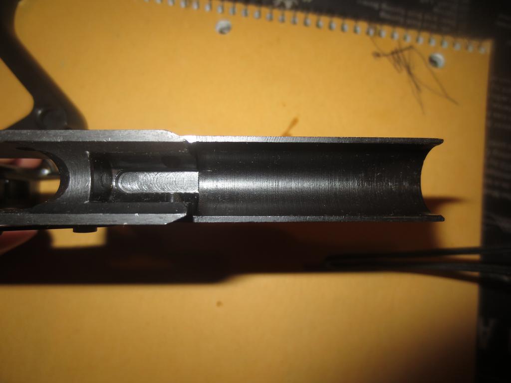

Thanks Claven for re-posting, it reminded me of something I meant to comment on earlier:

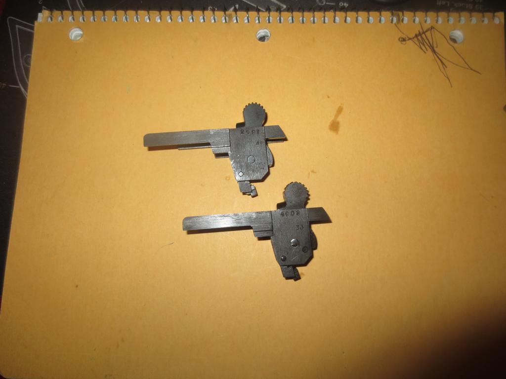

A quick way to ID non-refurb Russian tokarevs is to look at the back of the hammer group. In addition to non-refurbs not having renumbered parts or a GRAU repair facility mark (like a square with a line through it) on the frame - the back of the hammer group will be in the ####e where it was filed flush to the frame during original assembly.
Mine does have the GRAU stamp, but the hammer group is in the white.
I bought it from Lever a few years back. All matching, even one of the mags. I vaguely recall it was sold as refurbished.
It just means the hammer group in your gun likely came out of another gun and was not reblued at that time.
Notice how it's not flush with the frame? I was originally in a gun where the rear curvature of the slide was a little more rounded.
looks really good! thanks for posting. if you ever take them down part for part please post. i am also mostly interested when changes took place. like the slide cuts on the russian gun is an easy giveaway.
there is also a type 51 Chinese Tok. it has more markings on it and i am hoping out of the lot of surplus type 54s one might turn up in there. its easy to tell it apart.

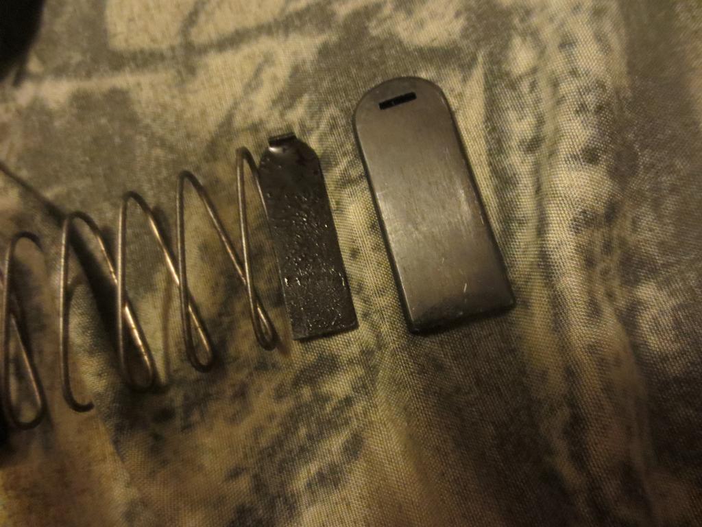

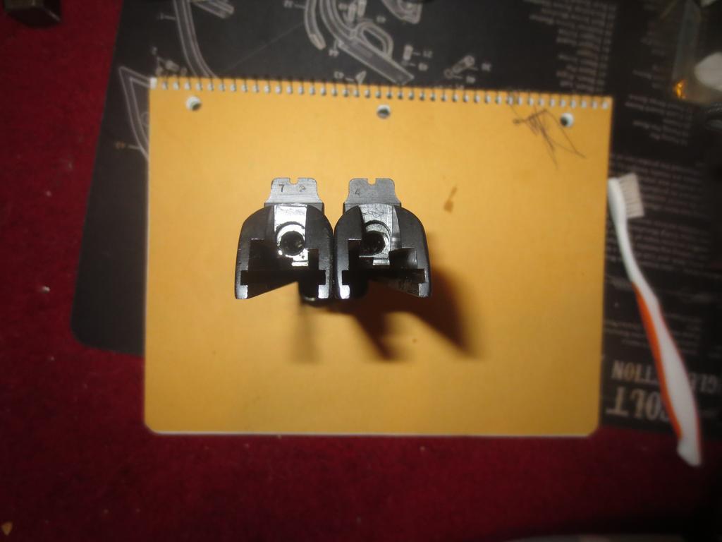

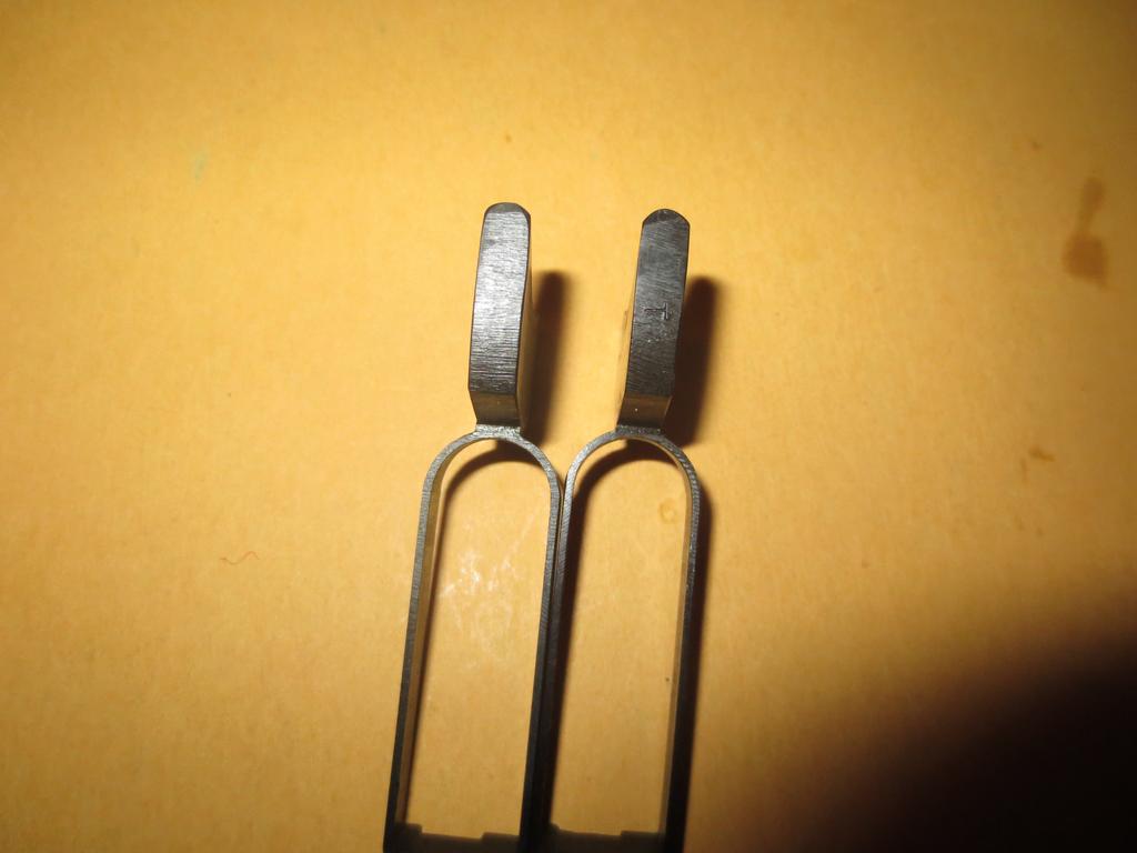

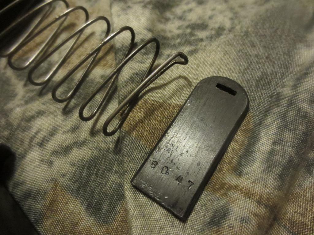

also one other thing i found is the mags are different. here is a pic.
I would not rely on the look of the back of hammer group at all. Some examples of original condition had it either blued or having same patina as surrounding blued surfaces. Sometimes it's really hard to say. So as to making assessment about condition originality I would go with combination of following observations: type of bluing, refurb markings, fonts of serials, surface wear consistent with age.
Ok, thanks then. That makes sense.
