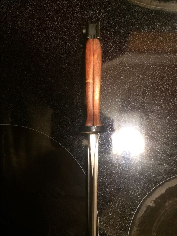

I finally took my bayonet apart albeit I broke some of the handle off. The rear section does come off after removing the screw and punching out the pin. I tried punching out the aluminum pin from the screw side and the handle shattered into three pieces. The aluminum pin had a head on the side I was punching, maybe the other side is smooth. A bit of epoxy and the handle was back together and no more handle rattles.
What was the process you went through ?
Well to take the bayo apart I had to drill out the rivet closest to the blade, then punch out the drift pin by the screw and remove the screw.
The grips (and handle overall) have to be shortened a little bit to get the barrel ring to sit on one of the rings on the barrel sleeve/grenade launcher. You don't need to cut the metal but you will have to relocate the holes for the pins and screw. I welded over the old ones and drilled new ones to line up with the new grips I carved.
I didn't want to mess around with trying to rivet the grips so I tacked on some metal around the hole and tapped threads in it to accept screws.
The grips them selves I hand carved and stained. Then finished with hardwood floor wax.
Good idea on drilling out the Rivet, better than me trying to punch it out and breaking the bayo scale.
