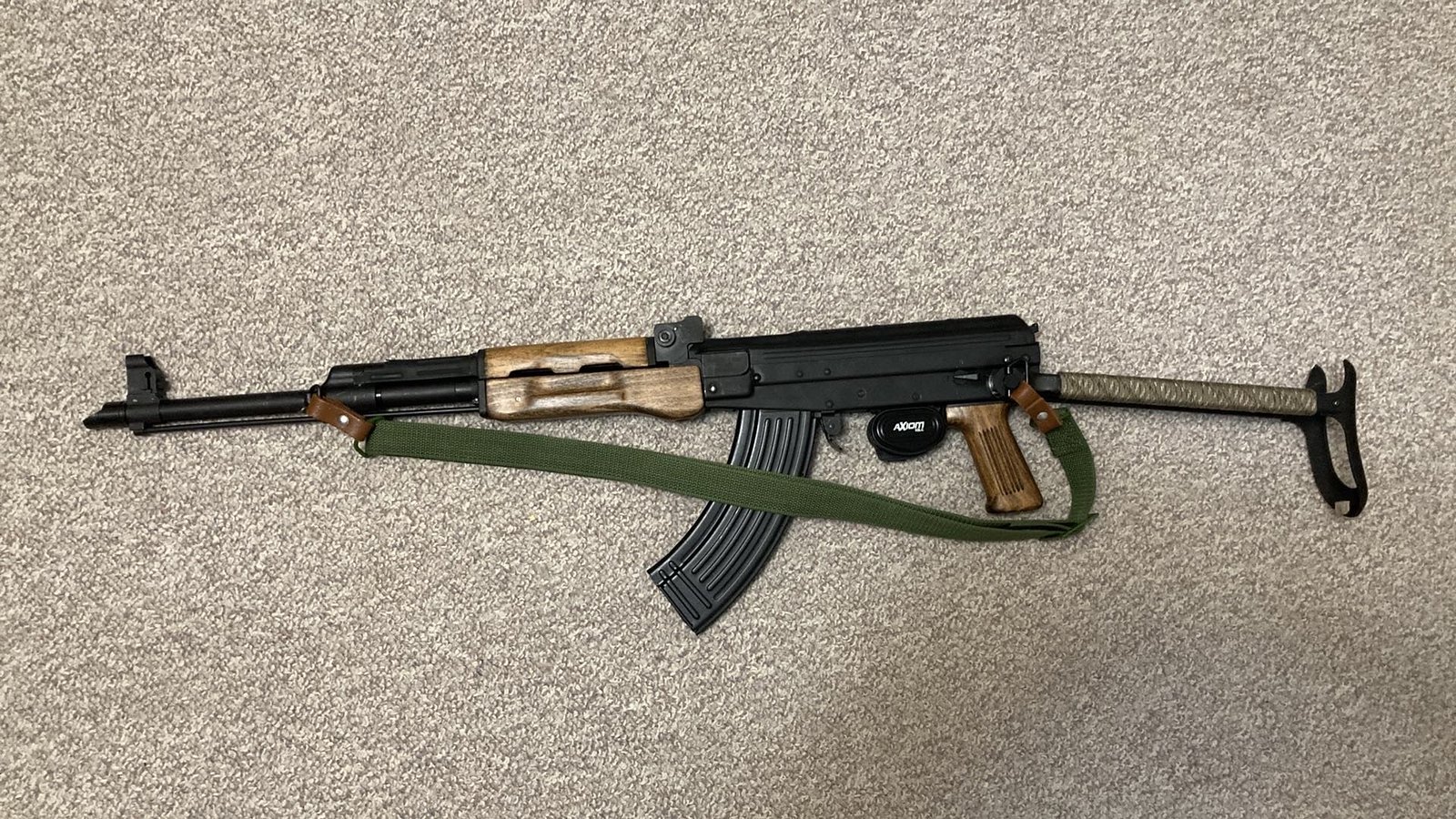

I am trying out this matching wood cheek rest. Its still more of à chin rest but at least its not cold to the face.. i doubt anything taller than this will work with the underfolder... if the riser is any taller, you'll need to twist your had pretty bad to get to the center line. But this one works and looks good. I left the top of the cheek rest paralel to the bore/reveiver, didnt want to follow the stock slant.
I havnt secured it to tne stock arm yet, still thinking of the best way to do that, might just drill and tap and bolt it on. We'll see..
Took the new underfolder to the range today. Ran about 50 rounds through it. No issues, no stoppages.
Forgot the sight wrench so couldn't adjust it. Was 3" high and 3" right at 50 yards, grouping around 4MOA with garbage chinese spam can ammo.
Didn't take any Barnaul - saving it for a rainy day since it's now unobtainium. My old T81SA was about 3MOA using the Barnaul which I would expect with the M as well.
Brought it home and ran boiling water through it and the gas system. Cleaned up real nice.
Fun rifle to shoot, let my hunting buddy have a go at it and a young kid who was there shooting his 22LR. He had a smile on his face after the T81 and then a Garand which he nailed 8 shots at 100 yards.
