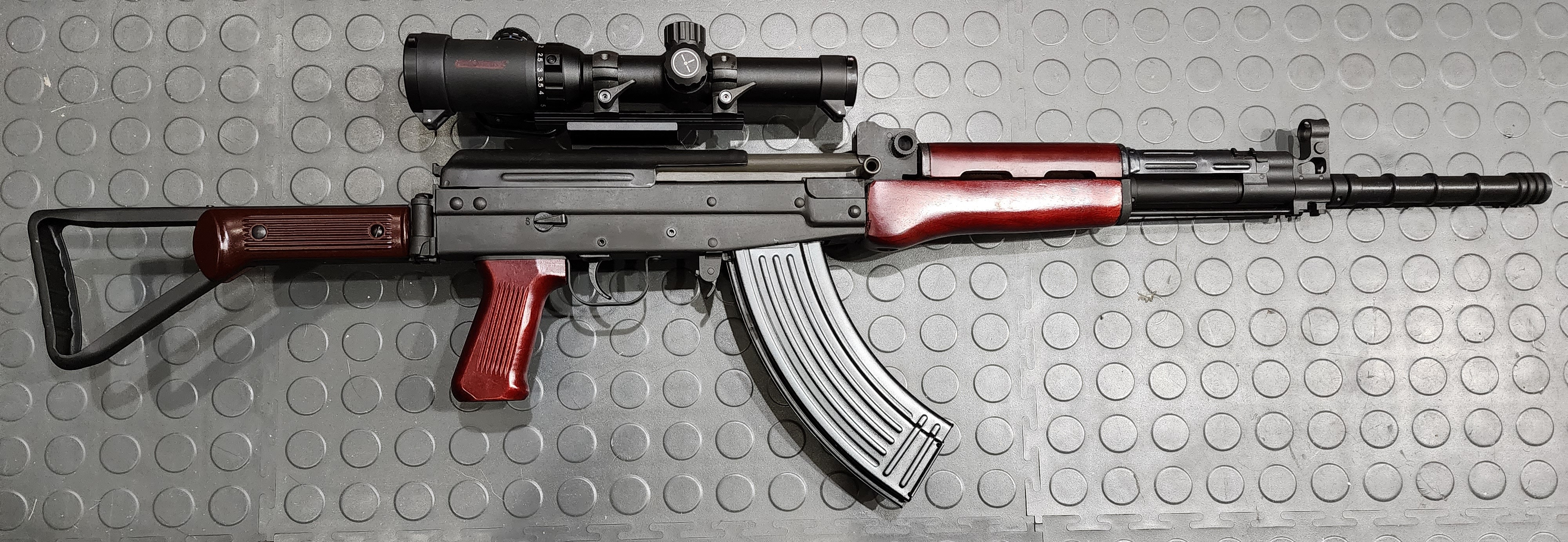

Mark, your scope may receive some dings from ejection of the brass after firing.
Yeah, I am kind of expecting that - I just mounted it the other day, based on my receipt of the 3-D Productions Side Rail. That's precisely why I went with a cheap $125 "Vision-King" 1-4X LPVO. If it takes a beating from the brass it won't bother me in the least. A cheap Chinese scope for a cheap Chinese rifle kinda made the most sense to me. If the LPVO fiails I will mount a cheap, short-bodied red-dot optic over the Body Cover (well clear of the ejection path) and call it done.....

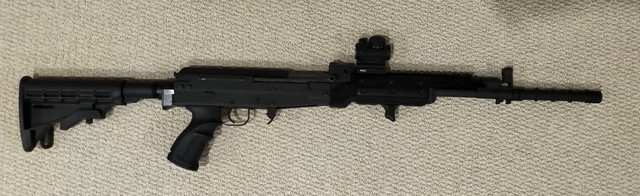

So, while everyone is waiting for their SR rifles to show up, I got my sigma/gyro stock adapters. I could finally put to use my parts bin M4 stock and I really like the result. Should it be in a black rifle section now?:p
Manufacturing quality is excellent, also I like how the adapter is secured in the rifle. Installation was straightforward and intuitive. Need the handguard extension to complete the build now.
interesting what do you need more to have to stock set up?
