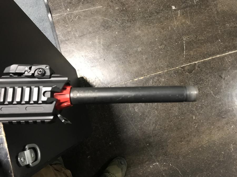

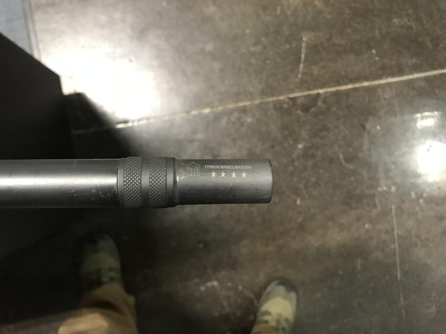

what's the choke thread on the barrel. very interested myself too. so its not ready to play out of the box, I thought the difference is just about their finish, didn't realize there are variety of models?
The model of Typhoons we have have a proprietary threading on the outside of the barrel.
Photos from our friends at SSIR rental typhoon:
