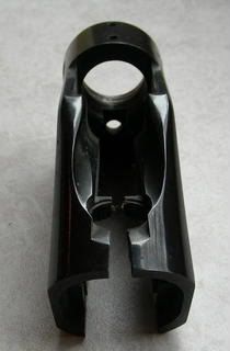

For those not familiar with the rolling block, this is a single shot with a rolling block breech to cover the cartridge.
Once closed, you can proceed to fire.
The rolling block is smooth and strong with a very positive lock, especially when it reaches the last cm before closing. You can feel the leaf spring assist in closing it the rest of the way.
The hammer pull weight is no more than any typical lever gun or such...
One thing that I did notice immediately was the trigger design...it's a two piece...meaning for those who know about the "Marlin trigger flop", you know what I'm talking about.
I would say the trigger weight is about 4 - 5 lbs with a clean, crisp break.
Upon extraction, notice the small little tab at the bottom of the chamber. It's slides out as you open the breech block and makes the spent cartridge back out about half a cm. Enough for your fingertips to grab. But as I spent more time downrange, I noticed if you open the block faster, it will flick the whole cartridge right out.
