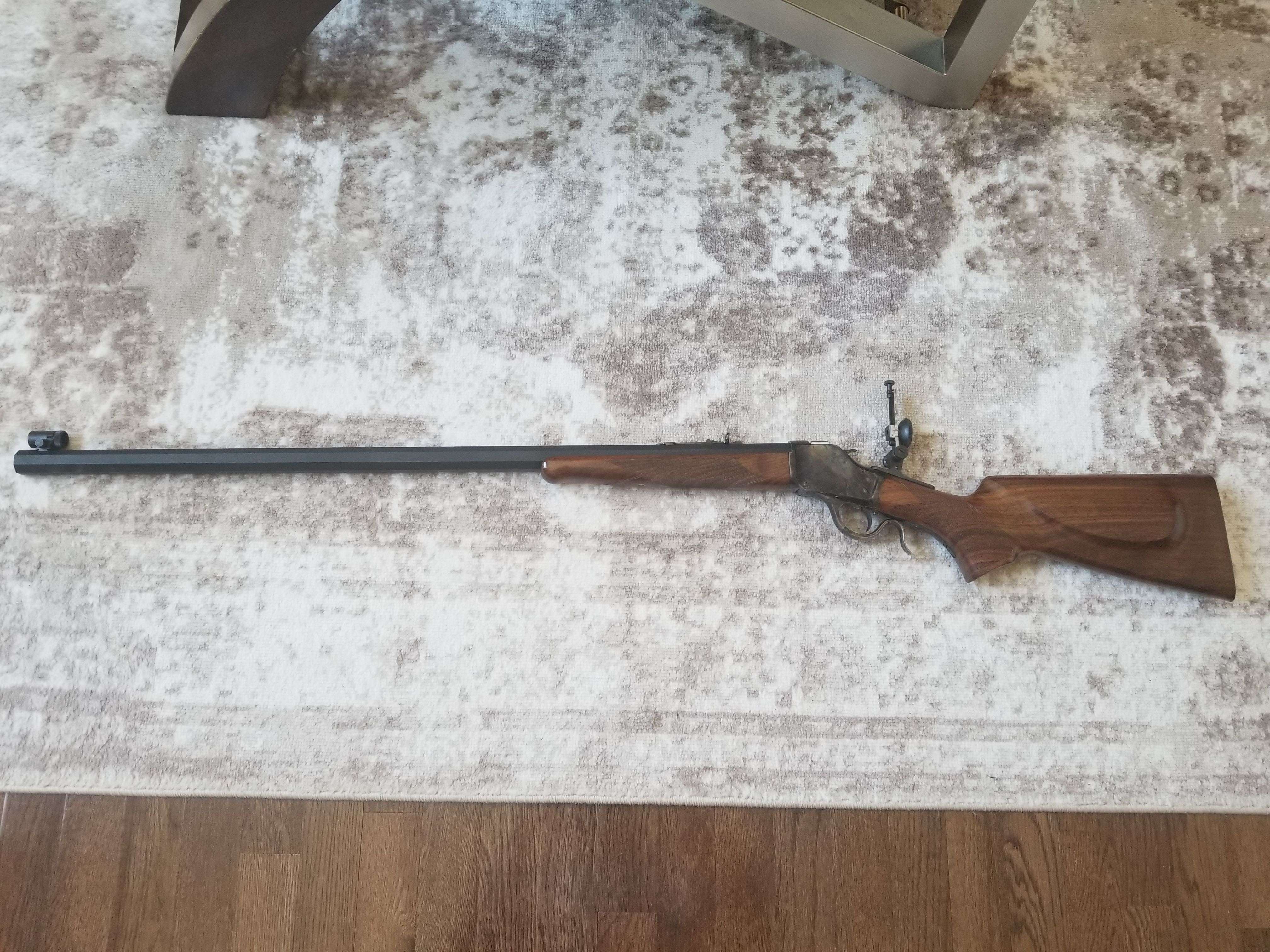

And here is a pic of my C Sharps 1885 high wall in 22lr.It is equipped with a single set trigger
