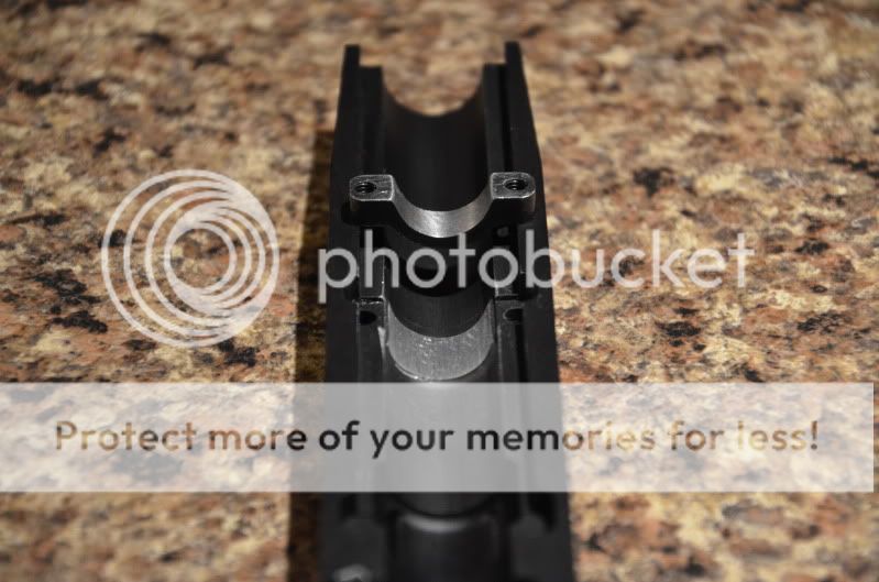

The area that needs the material to be removed when installing the M8 rail on a Shorty is shown here , pics from the 50calshooter thread .
The barrel lug has to sit flush with the rail when installed
