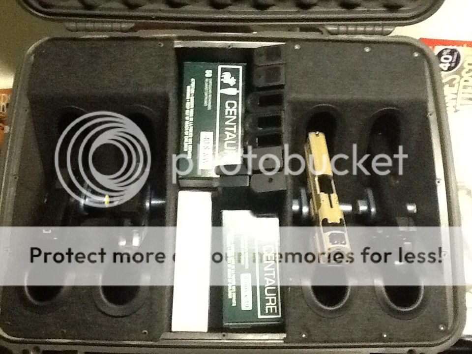

I went with the custom foam route from these guys mycasebuilder.com
For a case I already had, they have a sweet program to use to make your foam.
