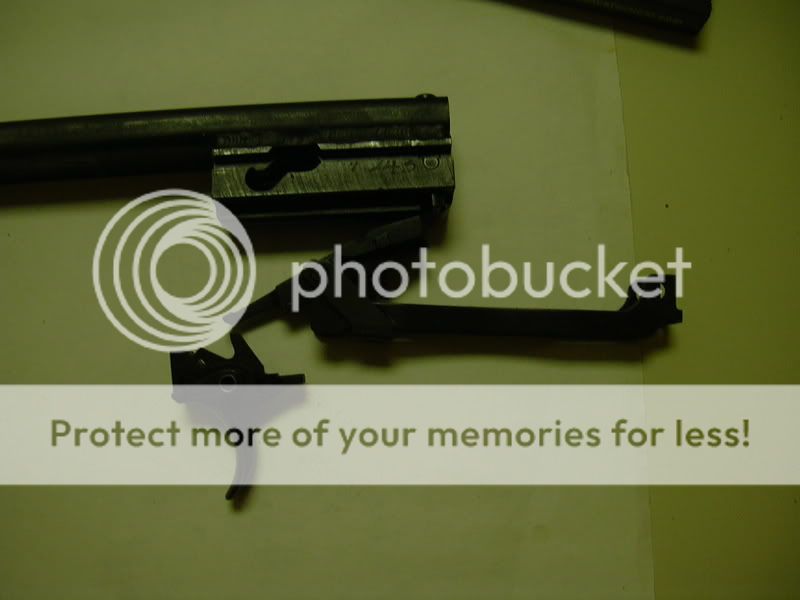

some one wanted to know what the firing mech looked like. The actual distance in higth is about .5-.75"
