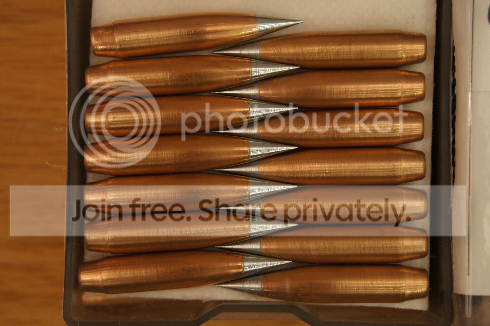

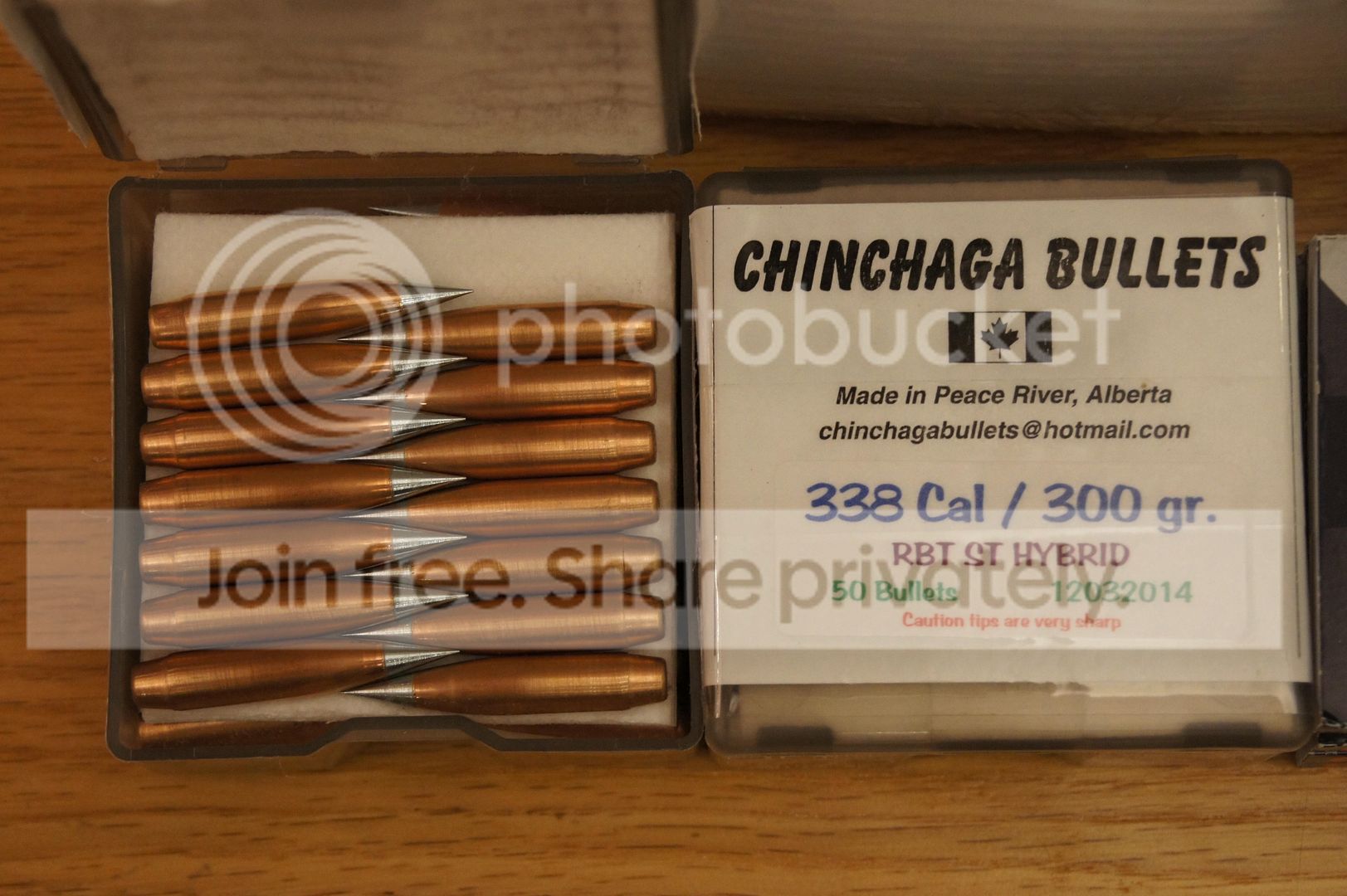

Just got a batch of these in from Chinchaga bullets, they are awesome looking little bullets, the BC is estimated at a G1 of 1.000, and a G7 of .475.
According to the guy who makes them (It is a one man show at the moment), who by the way was very helpful, and seems like a great guy to deal with, they are 300gr, steel tipped, rebated boat tail Hybrids. The steel tip is a small 14gr weight, and its purpose is to reduce meplat, as there is no way a jacketed bullet could be reduced so small for the purposes of ULD. They are a "hybrid" design, a secant ogive that transitions to tangent.
I picked up 100 projectiles, and they came packaged very professionally, and were in very nice plastic cases with layers of fabric between them, this is the best packaging I have ever seen bullets come inside of. I'm planning on making up a bunch of test loads for my gun and seeing how well I can get these to group whenever I can get to the range next week.
Anyways, just a shout out for what seems to be a great small company. I'll see if I can get these bullets to shoot accurately, and if I can, then I will be switching exclusively to them for my long range loads in favor of my 300gr SMK's, since the BC is light years better in the same projectile weight.
Here's some pics for you fellas!

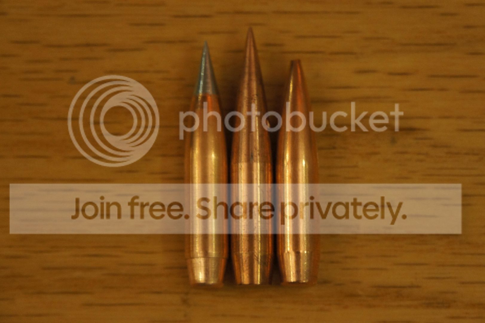

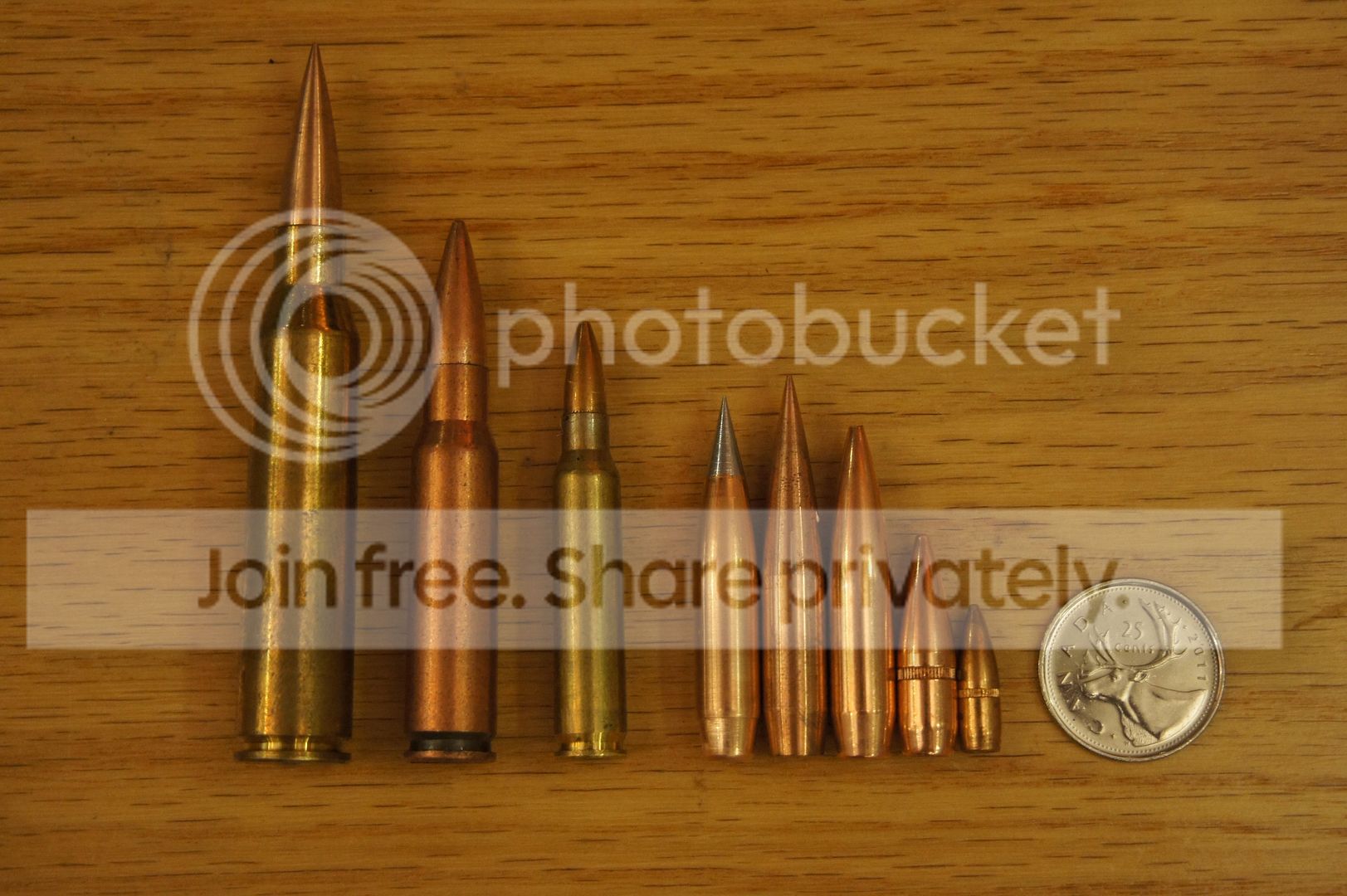

Projectile comparison... 300gr Chinchaga on the left, 270gr ULD solid copper Lost River Ballistics (out of buisness) in the middle, and 300gr Sierra Match King on the left.
A good comparison of three common precision rifle cartridges and their projectile size... from left to right:
.338LM : 308Win : 223Rem : .338 : .338 : .338 : 308 : 223

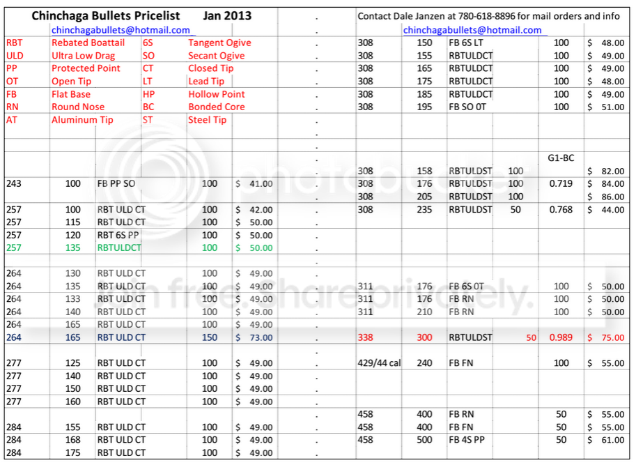

Here is an old price list, but as you can see, the prices are not cheap, but considering the quality of the projectiles you are getting, they are fairly priced.

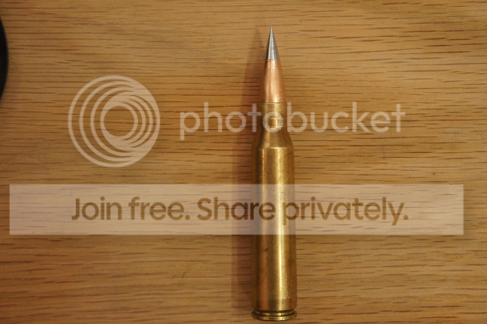

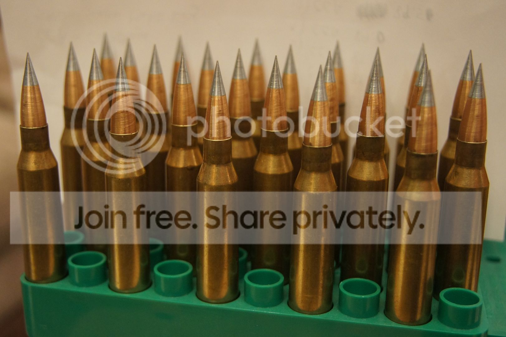

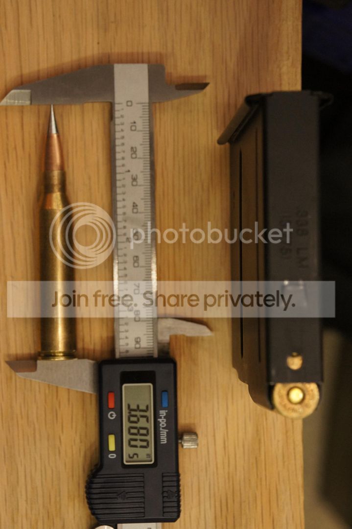

Got a bunch loaded tonight... just beautiful to look at.

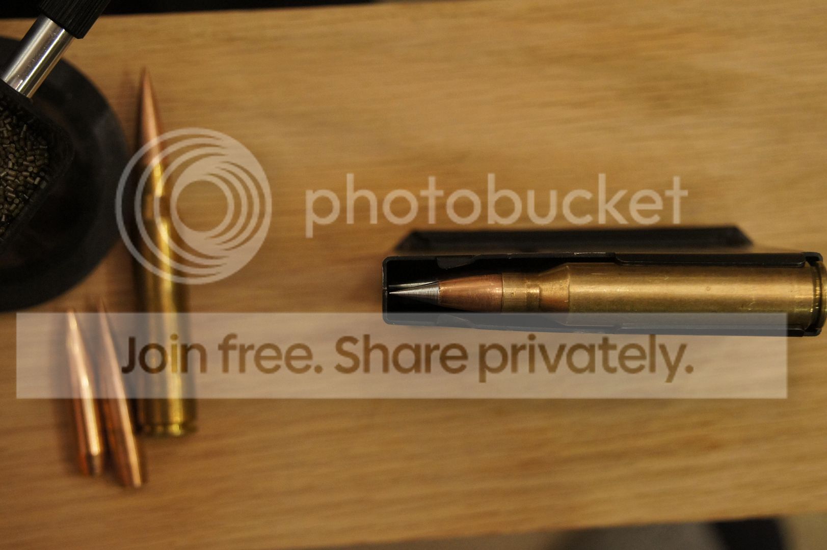

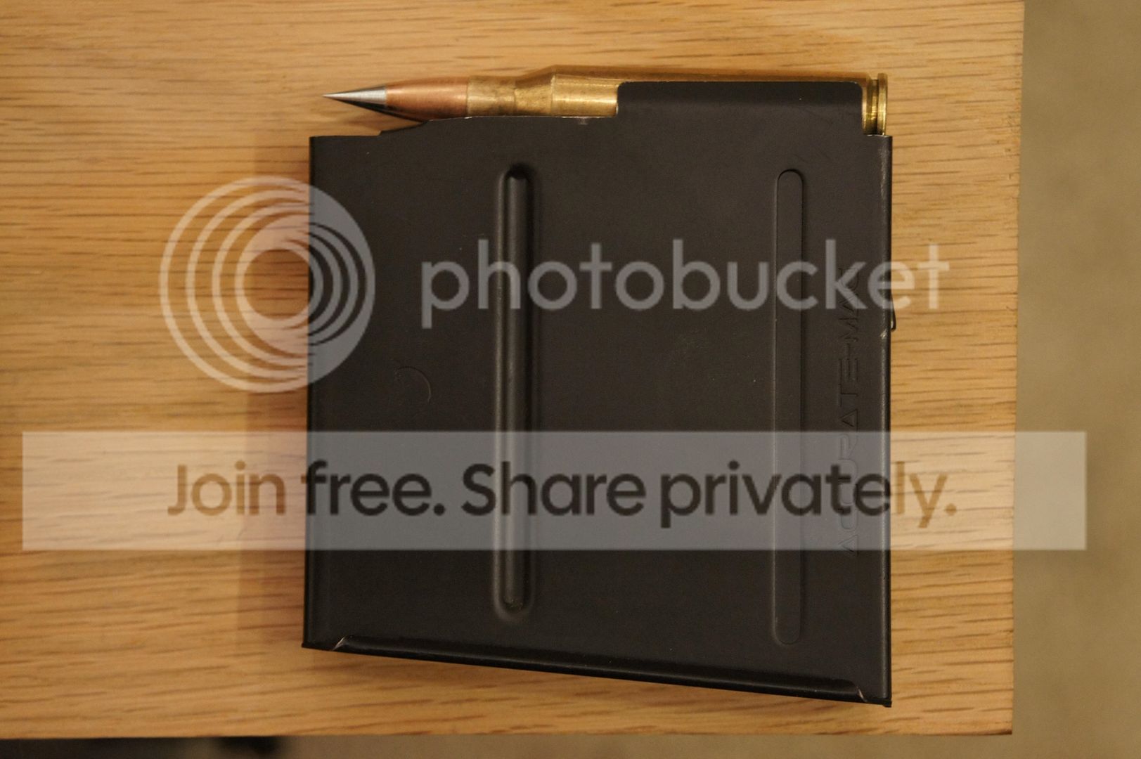

I seated them as long as possible while still allowing 100% mag function, because I hate single loading from a repeater. Got them pretty darn close to maxed out!
Video and pics.

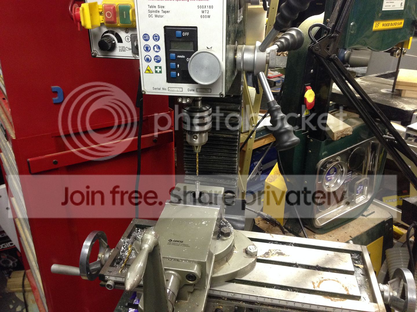

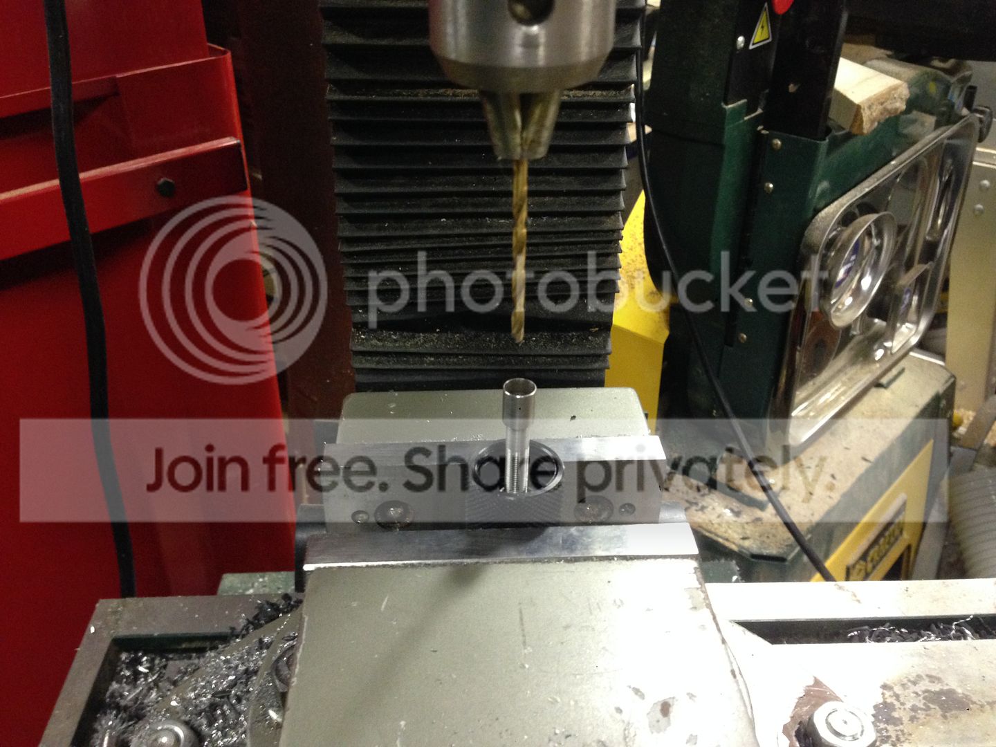

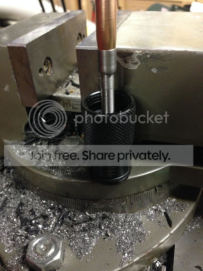

Some required modification to the seating die. The tip of the projectile bottoms out before is is fully into the seating cup on my dies, so the manufacturer recommended to drill out the cup using a 1/8" drill bit. Easy as pie if you have a drill press or a mill.
Proper fit of the projectile into the cup, notice no gap or wiggle room at the joint.
Snug as a bug in a rug.
Loaded to 3.680 out of a mag that has a max OAL of 3.775, but they feed reliably so I am happy with that.

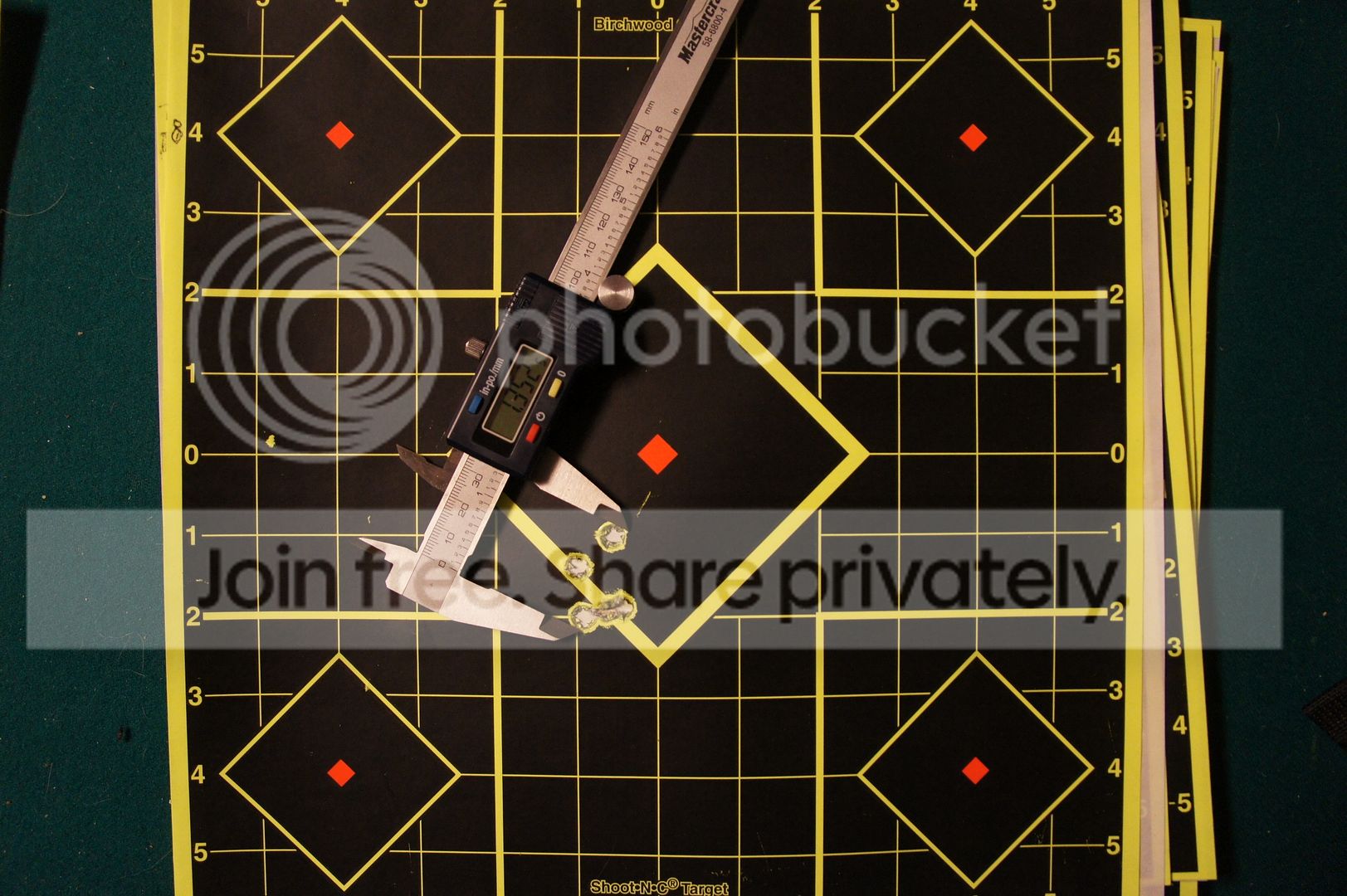

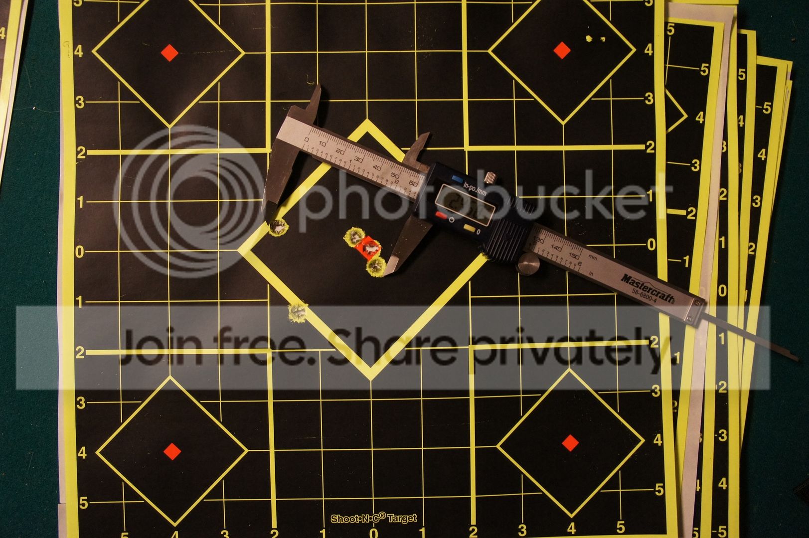

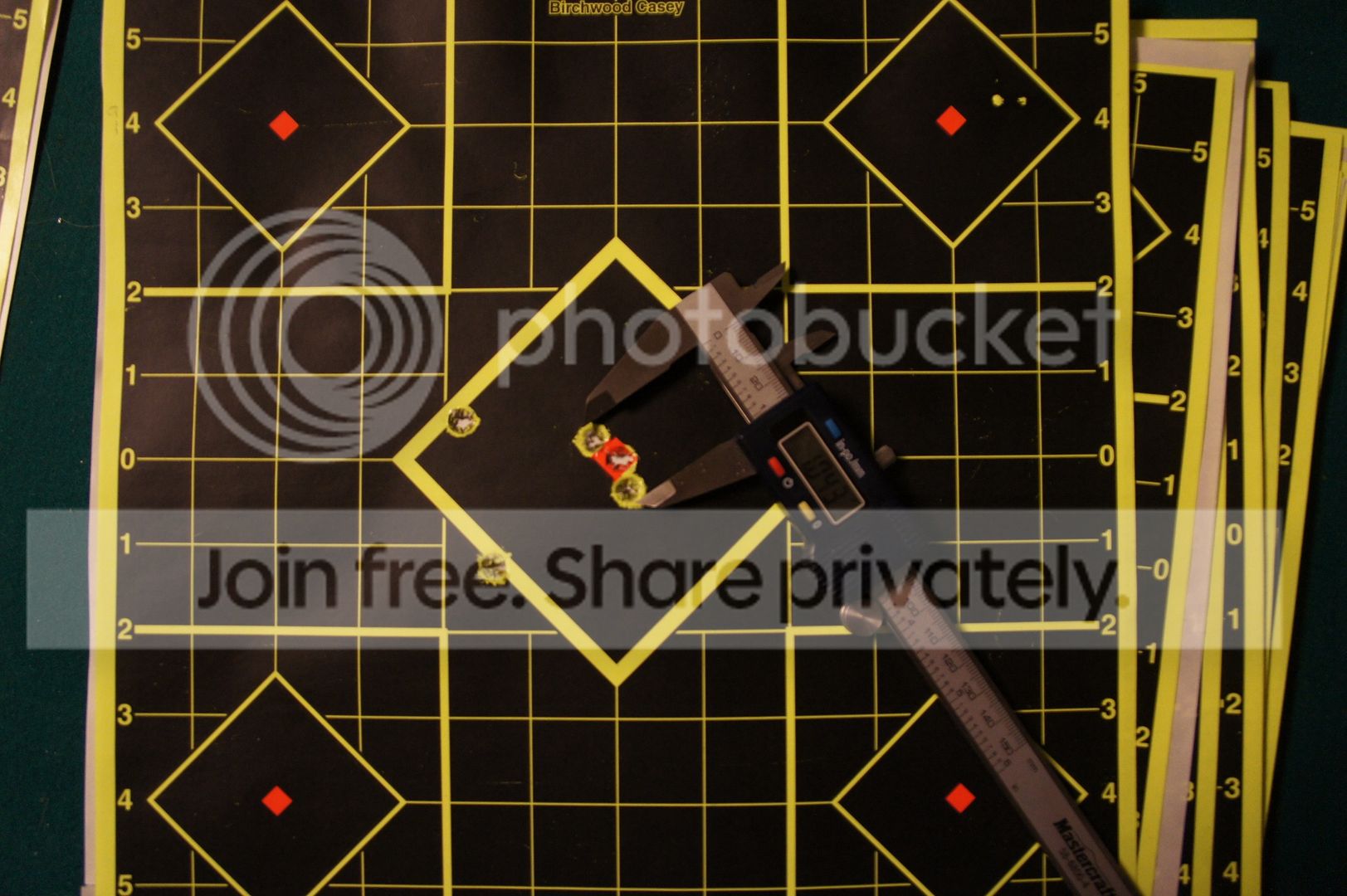

Ok, shot a bunch of them off today, all of them were pretty darned good except for the first test load which my gun absolutely hated using Winchester primers, and that grouped about 2 MOA. Not sure if there was another factor involved, but I am sticking to the CCI primers, because I got pretty good results with them.
All targets were shot 5 times at 200 yards from prone off bipod and rear bag. No mechanical rests or vices used.
Best groups of the day were with CCI primers, and between 88.0 - 89.0gr of H1000.
OAL: 3.680
I want to test a few more in this powder range, but I am happy with the at worst MOA groups, and best just breathing down the neck of 1/2 MOA.
Here is 88.5gr H-1000, this was the best of the day, and I am quite pleased with it.
I also want to retest 89.0gr H-1000 because I am reasonably sure I jerked shots 2 and 5 because I was starting to get pretty cold at this point, I had been outside for a few hours lying down in -10 weather on concrete. I think it may have potential, so I'll give it one more shot. I want to see if it was me or the load that screwed with the group.
