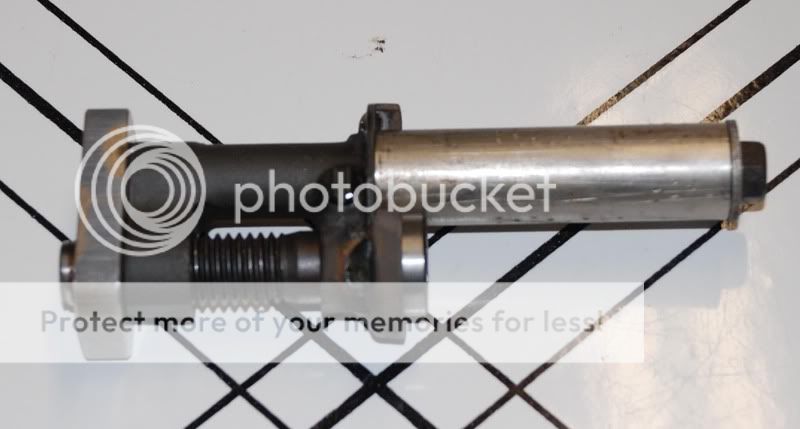

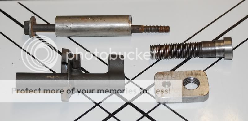

I asked a friend to weld up the gas system on my Nork M-14. He's a mechanic by trade and is very competent with lathes, milling machines, welders, &c. He works for the local gunsmith in Warren. He sometimes over-engineers things and before he did the welding, he make up this jig to hold the parts together in perfect alignment. I have two more for him to do and probably three others as well.

After a few guys had some trouble at the Jan 18 West Coast M14 Support Group clinic, I made a similar jig !! :)
It seemed like during welding while on the rifle the front band was getting caught up in a groove machined in the barrel between the shoulder and the straight cylindrical portion where the gas port is. The result was a few guys had to hammer or otherwise brutalize their rifles to get the gas cylinder off after welding.:eek:
I haven't asked Thomas yet, but I was hoping swing by during the next clinic with my gas cylinder and jig in the hopes of finally getting it welded ! :D
