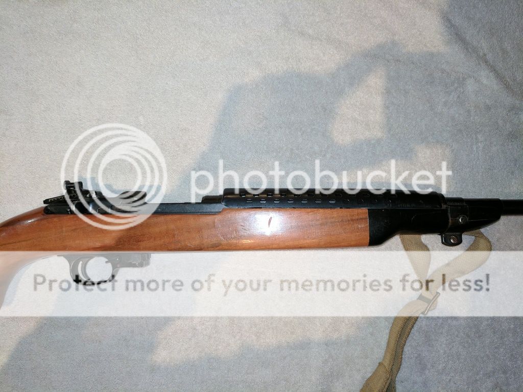

I've recently come into possession of a Universal M1 30 carbine. It has had a little bit of length added to the barrel I'm assuming to make it legal. Can anyone give me some info on this rifle? Possible value as well? At this point I have no interest keeping it as I don't want to feed it. I'll post pictures when I get the chance.

Google and you will find info on the 3 main variants of Universal Carbines, and how to tell them apart. In my opinion, value runs from $200 - $400 depending on which variant you have, and condition.
If that rifle has had a piece added to the barrel to make it longer, it is a restricted rifle. The barrel has to be one continuous piece from the muzzle to the start of the chamber. Be very careful with that rifle.

Its been registered as non-restricted in the past, don't think there's any issue. Can't seem to find anywhere that this modification would signify it as a restricted rifle. Please elaborate.
I don't believe it is possible to change a firearm's classification from restricted to non restricted by adding to or lengthening the existing barrel so that it would exceed 18.5". You would need to replace the barrel with a new 18.5"+ barrel.

Bearhunter & millwright are correct. Seems this M1 carbine barrel add-on issue has to continually be addressed. Semi-auto, centre-fire, fully rifled (except chamber) for greater than 470 mm (18.50") is the law now. Most common N/R length is 485 mm (19.1"), and 476.25 mm (18.75) . Externally, the extension seam is usually hiding under the front sight, so you can't see it til you look into the muzzle. Might be a smooth sleeve, or piece of 9 mm barrel.
I recently worked on a Gen III Universal, wasn't cycling properly. This is the first one I have had in my hands, and I have to say I was impressed with the quality of workmanship. New design features were intended to improve the USGI design, ie dual return springs, bolt hold-back feature, receiver drilled & 8-40 tapped for a side mount scope, but the major problem of cracking return slide is the flaw. New replacement slides are avail in US at around $99 USD. They are heat treated (as were the originals), so repair welding of the crack(s) is not a good idea. Gen III's also have an interesting feature of the gas port having a 2 position setting, one for S/A, and the other is for single shot.
The Gen III barrel/receiver are NOT compatible/interchangeable with USGI parts, so Criterion N/R barrels don't fit at all. Gen III's are a lot more difficult to rebarrel.
You can apply to register this carbine, as long as you have an RPAL. RCMP Firearms Registry is generally sympathetic to the M1 carbines with extensions.
Asking price of $400 -$450 with mag is about market value.

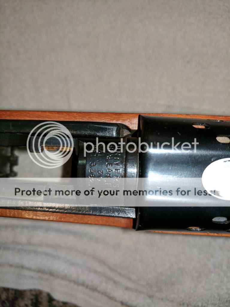

I honestly don't know what generation it is? I can't find the serial number on it at the moment. Judging by the band style on the forend, I almost want to say it's a GI. I'm assuming the barrel length is probably similar on mine, just with the addition of the extra metal it's hard to get an exact measurement.
Serial Number be where the rear sight overhangs. What does op rod look like, stamped steel, or google M1 Carbine Op Rod.
