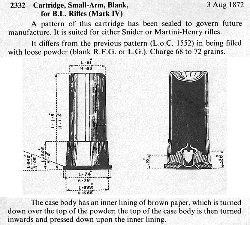

I've determined this to be a .577 Snider blank cartridge.
-Rim diameter: 0.746 inches (18.95mm)
-Rim thickness: 0.051 inches (1.29mm)
-Case diameter: 0.577 inches (14.66mm)
-Cartridge length: 1.711 inches (43.47mm)
