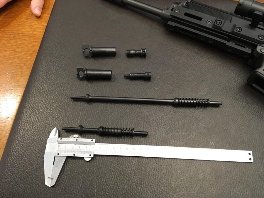

I hope I’m okay posting this for information purposes, I went to the CZ store in Prague looking for parts for a 16” bren. I was surprised to discover the factory 16” Brens use the 8-9” piston front which is flat on the gas port end, where as the CZ USA 16” bren has a pointed end which is basically the same as the 11” just a larger diameter. The picture is of the a 16” and 11” (5.56) gas system the guy pulled off the rifles in front of me. Note* the 16” guns gas tube looked the same as the CZ USA 16” gas tube, it was marked “HB” and had 3 ported positions -,1,+

That's not even half of the parts we've seen in these...lol. The HB is for the 16 in. rifles and stands for 'Heavy Barrel' meaning the 18mm gas block version. If you have a 16in. rifle you can also see this on the data decal on the side of the box beside the barrel length. If your still in Praha have a pivo for me !
