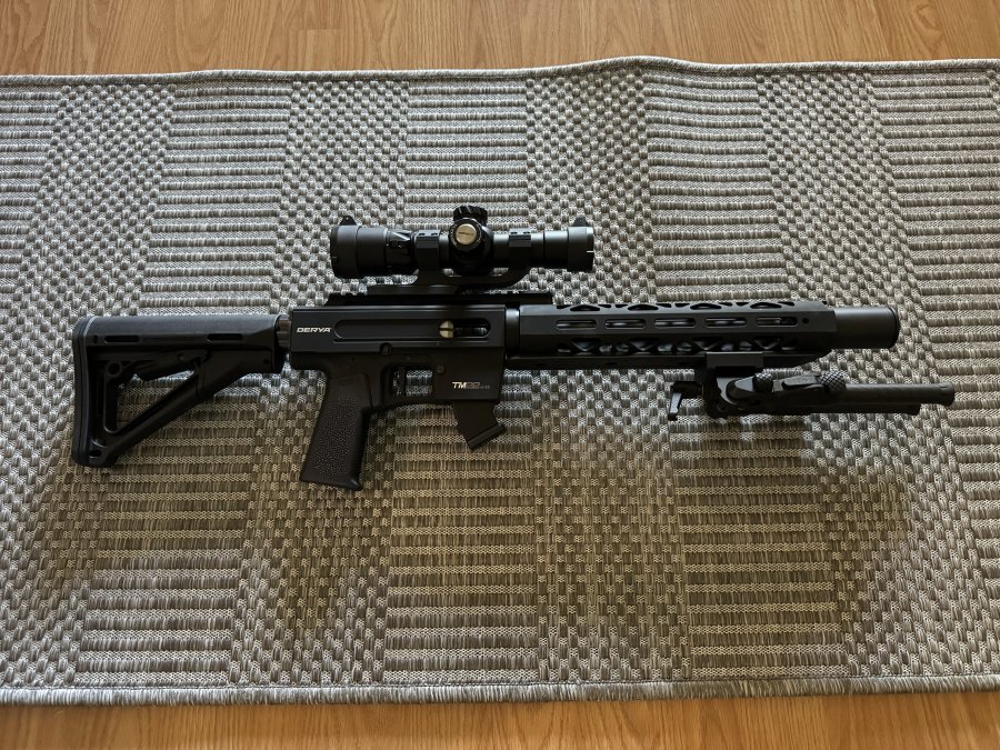

Here is a pic of mine with the Dlask barrel and handguard. I will be picking up a Dlask CH this week and I still have to decide on an optic but will probably go with a HS 508t or similar that I can throw on the Sw mount. It's a fun little rifle but I am not really a fan of the long LOP so I will either swap out that fixed stock with a milspec buffer tube and a CRT stock or I will trim the existing one a couple of inches.

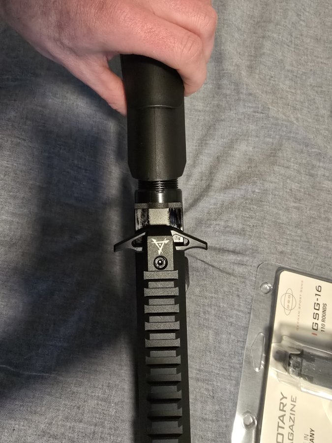

Get the Alex home brew top mount charging handle.
It's what I've got mounted to mine.
I've got ODG furniture on order(including mil-spec ODG buffer tube, castle nut, and end plate) to replace the black and then I'll send the rifle off to be cerakoted in ODG.
Ah yes, the home brew CH. I have heard about this. Where / how do you order one?
