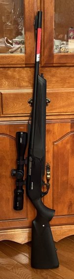

Tip of the hat to Clay & Team at Prophet River... I bought the Winchester SXR2 in 9.3x62 on Saturday, they had it in the mail with Canada Post on Monday (I know, I know & I was praying...) & to my surprise it was routed through Toronto & then Ottawa VS 'usually' going to Montreal & back to Ottawa...
Now, I know what you're all thinking lol... That Jay's sure got a funny roundabout way to get back into a semi auto 9.3x62 after that BAR fiasco AND YOU WOULD BE RIGHT!!! But here we are nonetheless :cool:
So, let's start with first impressions. The Winchester SXR2 is a solid feeling rifle that weighs in at 8 lbs 6&5/8oz and points like a dream. The ramped rib has a white line painted on it that draws your eye & a red fibre optic front post. It's a SOLID set up if you wanted to run irons. But with my aging eyes, it's scope all the way (more on that later)...
When it comes to fit & finish. I'm happy with the finish on the rifle, it looks good. Fit, well these stocks popped out of molds leave a bit to be desired AND I will have to take an edge off where my tigger finger lays alongside the receiver as there is a sharp edge.
The safety, it's a simple serviceable cross bolt on the trigger guard. The trigger, I really like the shape & how it fits my trigger finger, but again the trigger pull is just serviceable. IMHO both of these aspects of the rifle could have had a bit more attention from Winchester.
Over to the magazine. My first complaint is there wasn't a spare mag to buy WITH the rifle. To Prophet River's credit, once I mentioned this they immediately ordered them from Europe. Keep in mind folks, this is a bit of a unicorn here & I'm putting my faith in another semi auto 9.3x62...
The recoil pad on the rifle is rather stiff. I'd have preferred something a bit more squishy with the 9.3x62 but, only some range time will tell the tale...
Which brings me to mounting the scope! You'll notice that the SXR2 is sporting a Bushnell Elite 4500 2.5-10x40 :cool: That's NOT the scope I had intended to put on it. I was going to put my spare Bushnell Nitro 3-12x44 BUT, upon mounting the medium height Talley base & bottom 1/2 of the rings, the bell of the 44mm was 'just' touching the ramped rear sight! Initially, I considered removing the rear ramped sight but it looks cool, so I didn't want to. This sent me digging around in the gun cabinet for my Sauer in 9.3x62, remember that one? LOL! Yes, it had the Bushnell Elite 4500 2.5-10x40 on it and I decided to remove it, put the Bushnell Nitro 3-12x44 on it...
So now I have TWO 9.3x62 rifles to sight in sometime this weekend! LOL
Now, who wants some pics?
