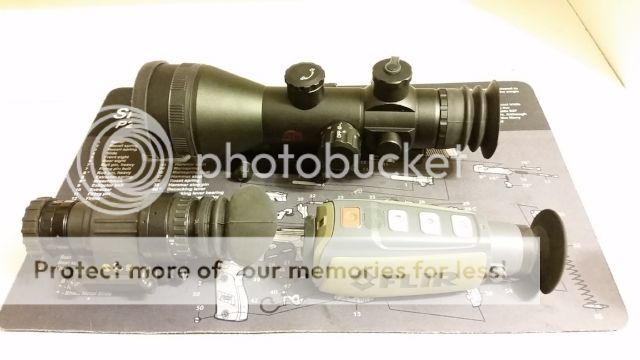

At the back we have the ATN Ares 4 CGT. This scope is a Gen. 2 4x magnification rifle scope, and it comes with a detachable IR illuminator. It has automatic brightness control, and a green or red reticle. I do not have the reticle visible for this test.
At front left, we have my latest acquisition. It is a milspec PVS14, with an L3 Gen 3 tube. It is not autogated, and has manual gain control, and a built in IR illuminator. I bought this used from our very own TV-PressPass.
The front right is a FLIR Scout PS32. This is the first edition of the Scout line, and it features a 320x240 pixel microbolometer (the IR sensor) and a 320x240 viewing screen. It comes with a charge cable, and a soft carry case.

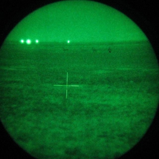

First is the ATN Ares:
While the picture is not a perfectly clear representation of what this optic shows in real life, the first thing I noticed when I first use this scope, was that it may well be difficult to positively ID something if it was further than perhaps 150 yards away. Even at 85, while the tombstones are fairly clear, and a coyote would be easily recognizeable, it is easy to see that the small details are starting to diminish. This is amplified as the ambient light decreases. The one advantage about having a 4x magnification in a situation like this, however, is that you will not get as many lights blooming in your view.

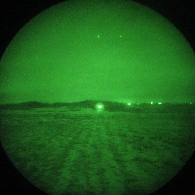

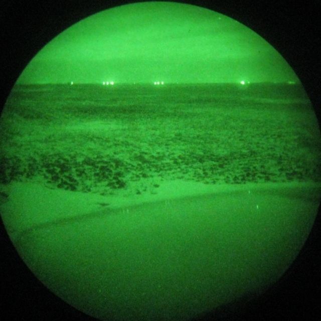

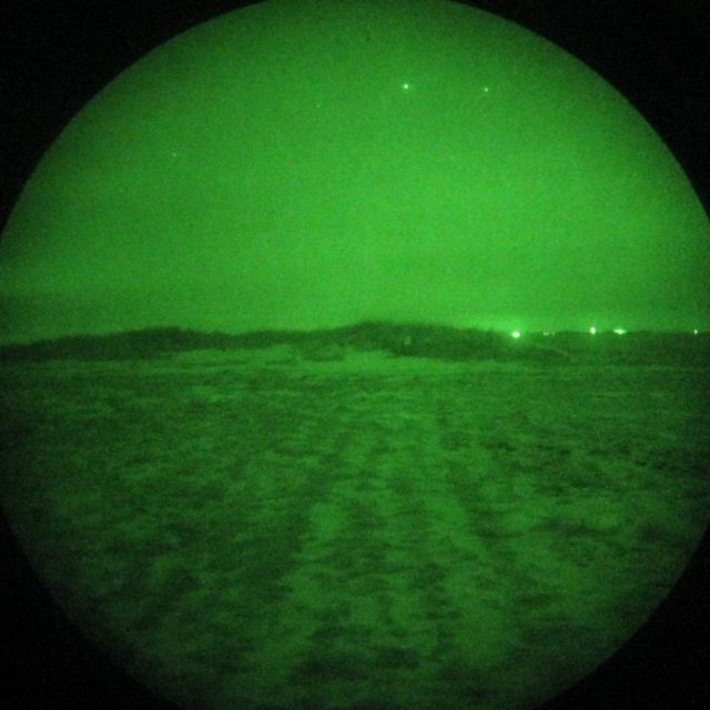

Next up is the PVS14:
The pictures do show that there is decent clarity, however, there are so many lights in this picture, that you are hardly able to see what might be going on in the cemetery. In real life, it was easier to see what was going on, and with the manual gain, it is something that can be adjusted for, but at the expense of not seeing as well into the shadows. I very deliberately chose this picture to show what I can see as the only downside to a larger field of view: way more lights to bloom. It also may be hard to determine what you are looking at without any magnification, as it is the same as looking at something 85 yards away with your bare eyes.

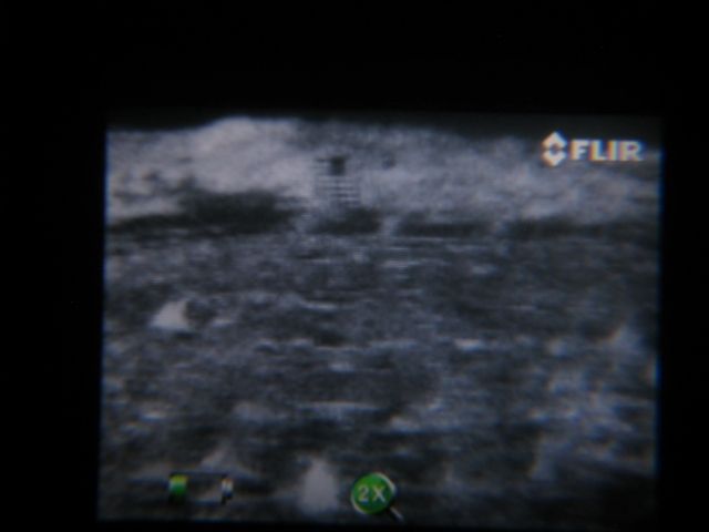

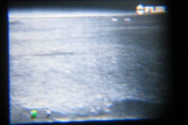

Now the FLIR:
This was the most disappointing of the bunch, and it has been something I've seen in the last hunting season as I tried scouting with it: looking from afar at an area with even moderate density of trees, it shows up as a giant blob of heat. It is very hard to see any differentiation between trees, open space, and tombstone. I have found that if you are in a wooded area, it will work amazingly well, as well as if you are looking around the block at houses. On the open prairie, and in more open spaces, it seems to struggle.
Now the FLIR:
