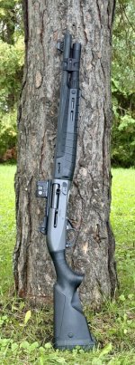

Received my Benelli M2 G1 and made my way over to Tactical Ordnance, for some upgrades and accessories.
1 - safety
2 - lifter
3 - magazine extension
4 - clamp
5 - Aimpoint ACRO P2 9 MOA
Stay tuned for range feedback once I have the opportunity to put some rounds down range.

Looks great! Just picked one up as well. Does the tube extension give you 5x3” 6x2.75”? Would you mind sending the link for the tube and clamp?
Yes, mag extension will allow no more than 5 - 3 inch shells and will also hold 6 - 2 3/4 inch shells.
It is a Nordic Components BR coupling nut with a +2 mag tube extension kit (with permanent plug)
Mag clamp is a Nordic Components Mlok clamp.
https://tacord.com/product/nordic-mxt-extension-nuts/
https://tacord.com/product/nordic-mxt-shotgun-magazine-extension-tube-kit-12ga/
https://tacord.com/product/beretta-1301-tactical-a300-ultima-patrol-barrel-clamp-mlok/

Thanks! Just ordered

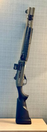

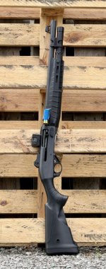

Updated some accessories, Tactical Ordnance removed the picatinny rail to install Scalarworks Sync mount for the Aimpoint ACRO P2 9MOA, during the installation we had a compatibility issue with the polymer rear ghostring and had to replace it with the LPA rear, worked out without an issue and installed a Briley stage saver.

Is it worth swapping over from M4 based on weight and stock? My dilemma.
Also can you explain more about the issue with the rear sight removal with scalarworks?

Having owned several Benelli M4 shotguns, I am comfortable with this being a replacement if I was in that frame of mind, the Scalarworks mount will not fit with the new polymer rear sight on the M2 ( polymer rear sight is a little longer than the steel on ), switched out to the original LPA rear sight and it fit without issue.

I see what you mean about the rear sight, thanks for the picture! Is the LOP on the stock is about 12 inches then I would like this a lot. Also seeing that price is around 1.9k it pretty competitive to 1301.
Was the lifter tuned or replaced?
I will be sending him my M4 this winter and wondering what the recommendation is….tune existing lifter or replace?
Nice shotty by the way!
Glad they are now comfortable doing the Nova Speed loading port cut for customers.
A friend had them cut his 1301 comp pro the same way.
Tactical Ordinance does phenomenal work, they did a m4 for me and it’s wild… is that the factory trigger guard? If so that’s a really nice factory upgrade.
