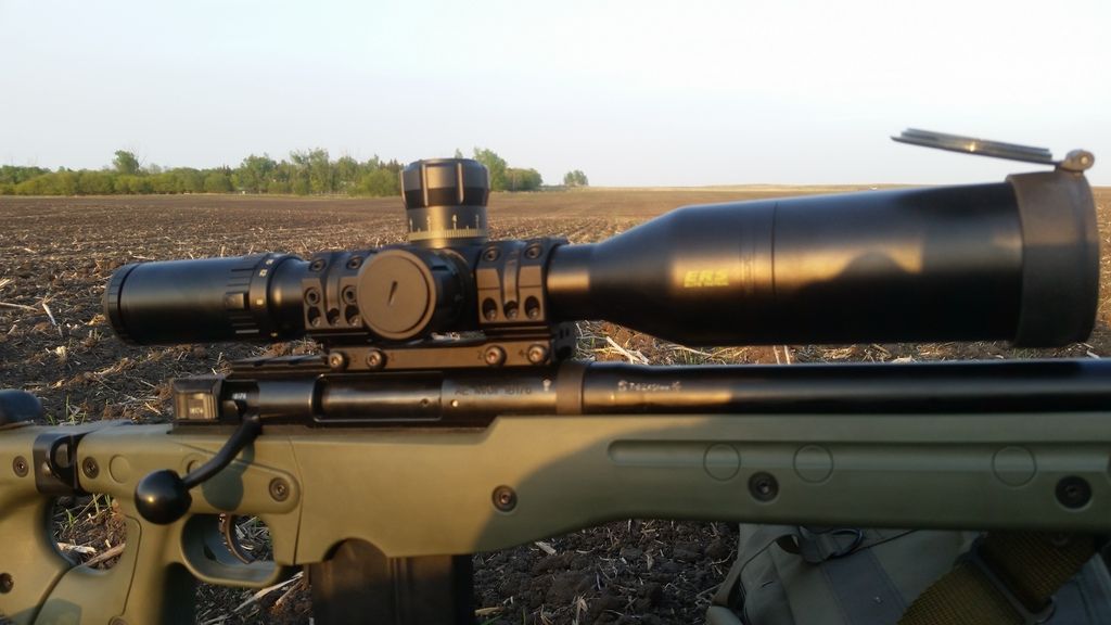

To get the eye relief I needed with that rail I needed to cantilever the mount off the end of the rail. It still seems solid enough with three of the four cross bolts.
Here's a fuzzy picture:
The mount is very solid and the built in level is very low profile so it won't snag but it is partially covered by the scope while shooting. It is still usable though.

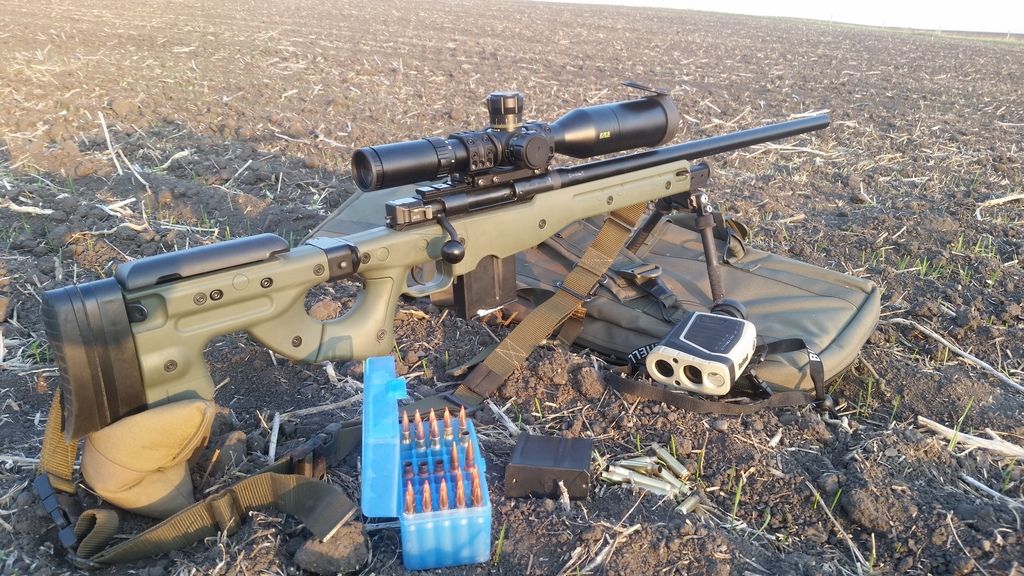

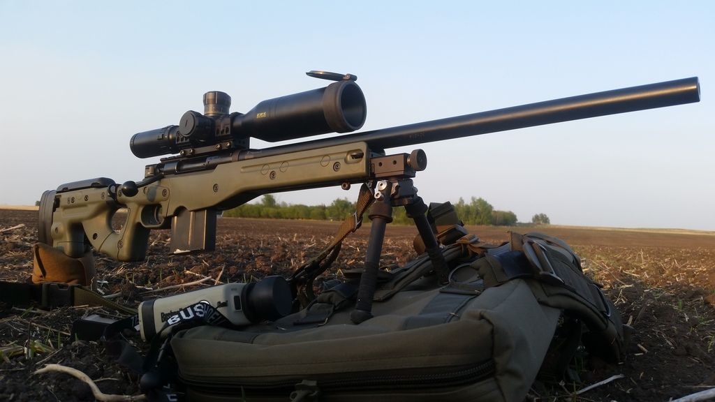

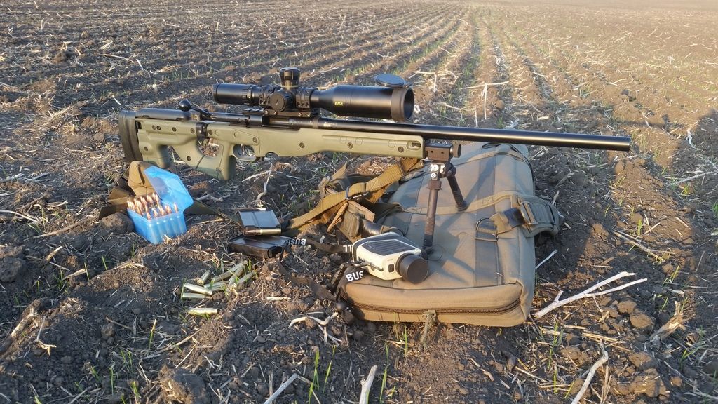

Anyways if anyone had the patience to read through my boring review here are some pics of my new setup at my "range":
